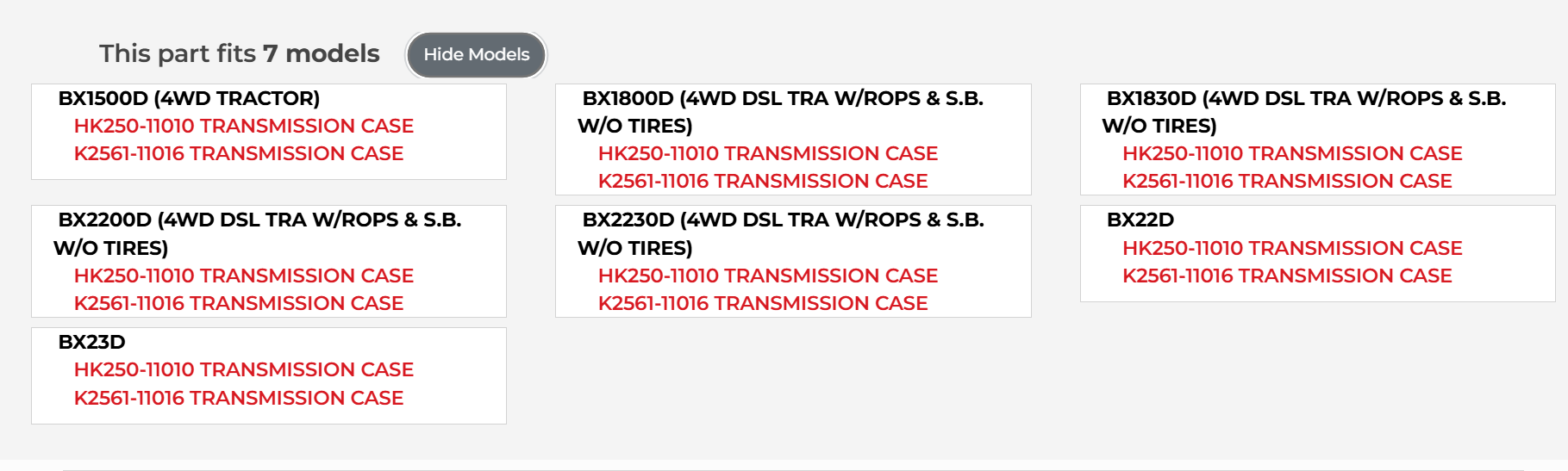

Is this the part he needs?
If it is the part he needs tell him to buy a new tractor, with a warranty and a maintenance plan.
Because to fix his with labor and everything he's going to be into it for $10K when he's done.
Not worth it!

Bx1800 bx1830 bx2200 bx2230 bx22 and bx23 all use the same transmission. Bx1500 does as well but the hydrostat is different but you can bolt your hydrostat up to it. Having said that all of them are very hard to find and expensive. I have plenty of transmission parts but no complete transmissions right now.
