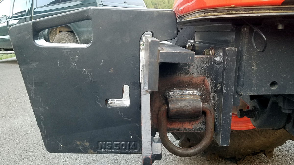

When you're a welder and a pack rat and you refuse to get rid of anything made of steel, you can tell yourself that many upgrades and additions are "free". That's what I tell myself when I repurposed the D-rings off a front and rear bumper I'd made for the Jeep about 24 years ago. 😂
The rear D-rings were welded to a section of box tubing that didn't lend itself well to being part of the installation on the M6060 front weight bracket, so it was a bit more work getting them off. The front D-rings were welded to a larger piece of suitable steel, hence the square plate that's welded to the grill guard.
I only use the D-rings to chain the tractors to a trailer, but I used them many, many times with a winch and snatch block pulling unprepared folks out of tricky situations on the many trails in Hawaii. I even did some recovery work for my friend with the Jeep and those D-rings. He owns a recovery business on Oahu and would sometimes call and ask for my help when he was unable to get his equipment into areas where a vehicle was stuck. So those D-rings are well tested and were made in the US decades ago with forged parts so I have little doubt of their durability. The D-ring is forged as a single piece so no welds to fail.
The bigger challenge is figuring out a system to chain the rear of the tractor to a trailer. I use the drawbar and a shackle, but I think I need to make up some kind of vertical support to go under the drawbar to prevent it from bending under load from the binders. Now that I think about it, maybe a jackstand under the drawbar would work. :unsure:

Thanks! Yeah, I think for the most part hoarding steel is a blessing rather than a curse, but I will say it often takes longer to make things using steel from the scrap pile vs. new steel bought specifically for a project. I do enjoy turning $hit into sugar though. 😂
Your D-rings look to be more than enough for the BX and it's a good and affordable upgrade for anyone interested in chaining their tractor to a trailer or pulling it or something else.
