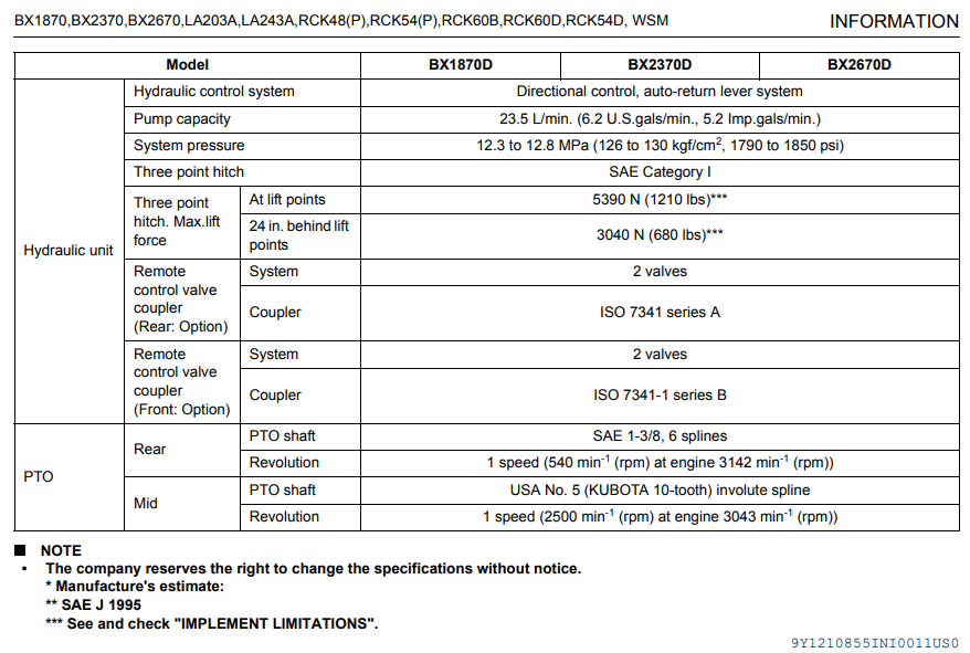

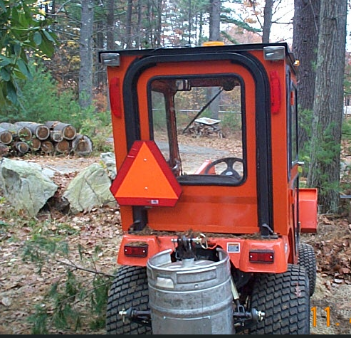

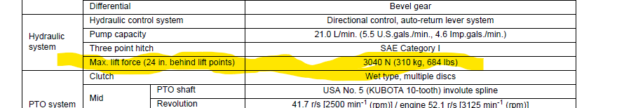

I have a BX2200 and use a weight box on the rear while plowing. Sometimes I hit the lift lever by accident and the weight box falls. I see there are places to hook the lift bars to the tractor and not the lift. If I just moved the lift bars over, the weight box would be too low. Do they make shorter lift bars or do I have to make my own.
Does any one see anything wrong with keeping the weight box up for the winter? The box is about 700#
