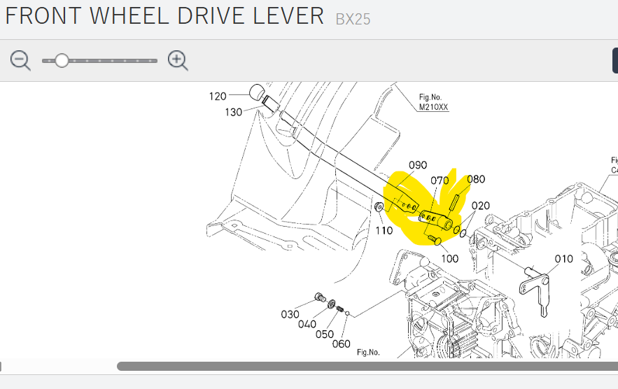

i have a bx25 2011 with 550 hrs. for 4 weeks ago i begin to have a 4wd issue. for keep in 4wd in need to keep a pressure on 4wd arm. problem with a gear??

Check the linkage thoroughly first!

parts 50 and 60 is for?
i check tomorow, just allignemnt
Detent, they give the lever that click when engaged and disengaged.
You could check that the spring is not damaged, but highly unlikely that is your issue.
