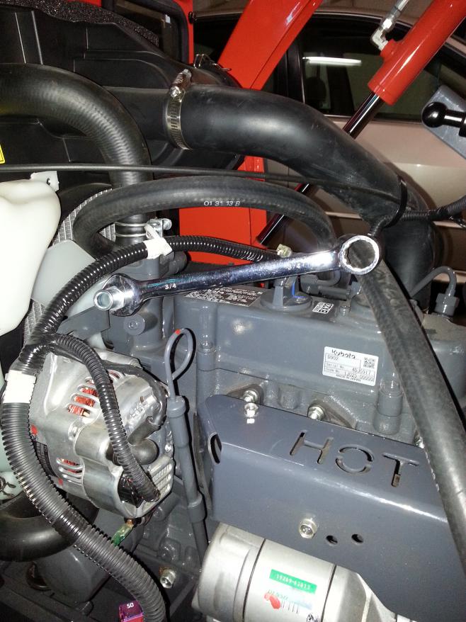

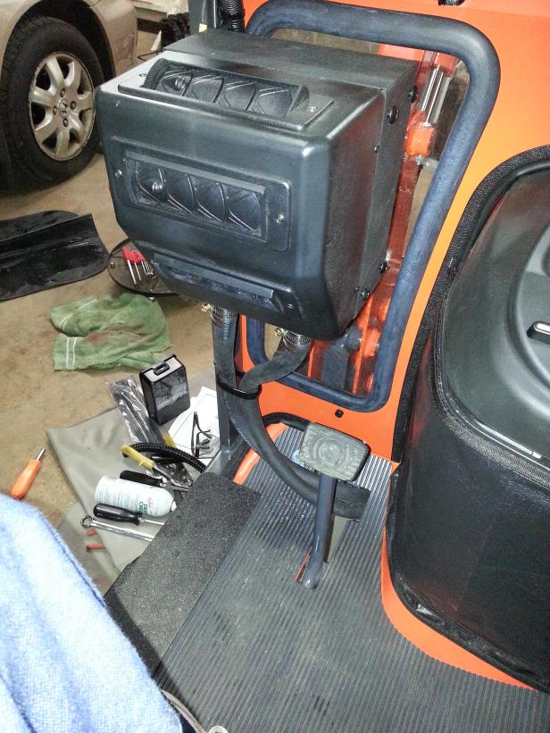

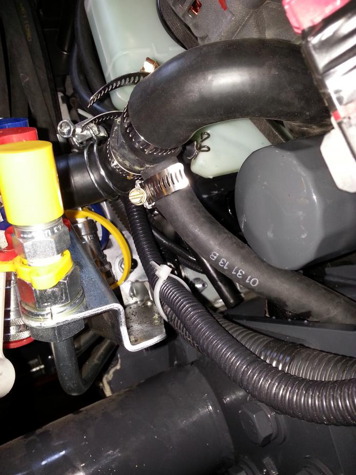

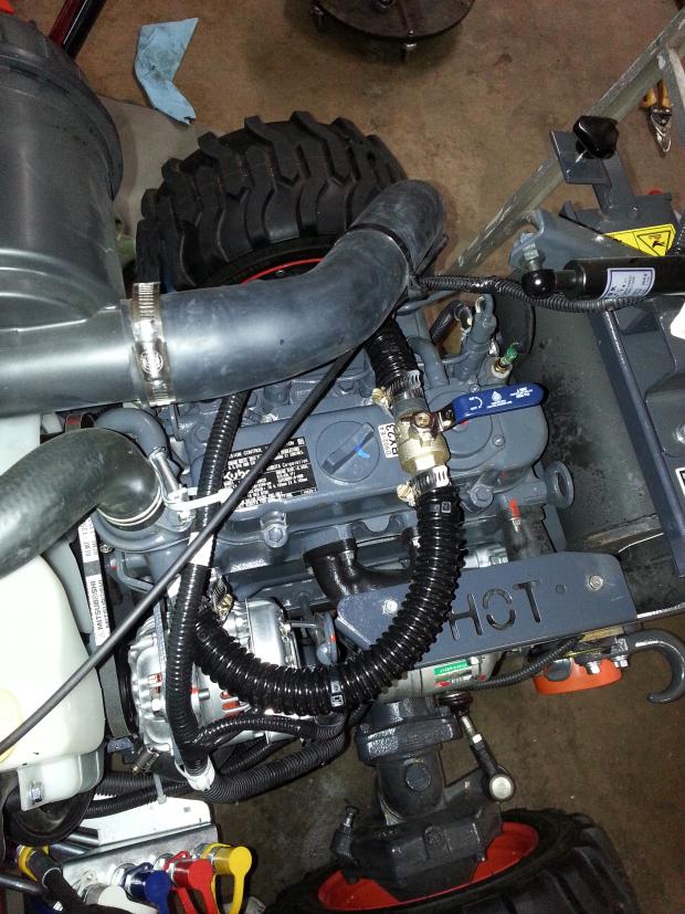

I checked our tractors today for the heater hose hook-up.
One hose goes from the thermostat housing, then there is a valve in the line to shut off the water flow during warm months. This hose then goes to the heater. It leaves the heater box and returns to the lower radiator hose.

I made my own cab as well. I am about to hook up my heater as too. I like what tcroat did. What do you think of using the water pump bypass and plumbing it into the upper radiator hose. After all that bypass hose is there for minimum flow. If you keep it that way in the summer I would think the extra flow going into the radiator. would help keep the engine cool. We had lots of pumps at work that the recirculating line was 1/3 of the capacity of the pump. Kubota are known for running hot. The rest of the machine is designed very well. Maybe this is a design flaw?
screwsloose
bx2350 loader snowblower, 5' blade, heated cab, mower
May 9, 2011
brillion wi
Now that I think about it. the old s-10 pickups used the bypass hose to the heater core and a lot of them went into the top of radiator.
I hooked it up from the bottom of the thermostat to the top radiator hose. I store my kubota in a heated garage. The engine never got up to temperature. It was 30 degrees out. This shouldn't have been a problem at this temp. Needless to say I will be hooking it up into the water pump bypass lines, as soon as the parts come in. I would hook it up as recommended by Curtis but I don't want a shut off valve in my system.
