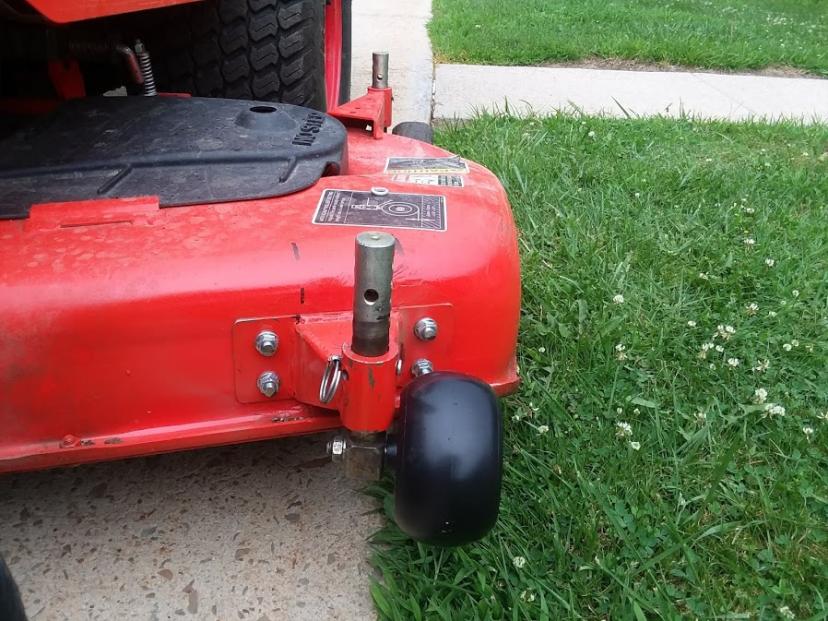

Hey guys,
New to the forum: My problem is my tractor has had a problem since new. The left front deck wheel mount, broke the first summer I used it. The weld broke where the round part that the height adjuster is.
The dealer attempted to weld it, but it broke again a month later.(Bad weld)
They tried welding it again, and it finally broke completely off today. Now for the good part, the dealer went out of business and I now have to do business with a dealer 35 miles away. They told me if it has been welded twice already, it can not be welded again because the metal is weak. they told me I can cut the existing bracket off and they have a replacement fix that bolts on with 4 bolts.
Has anyone ever heard of this fix before? Also, what is the proper distance between the scalp wheel and the ground? Book says 1/2 inch:confused:

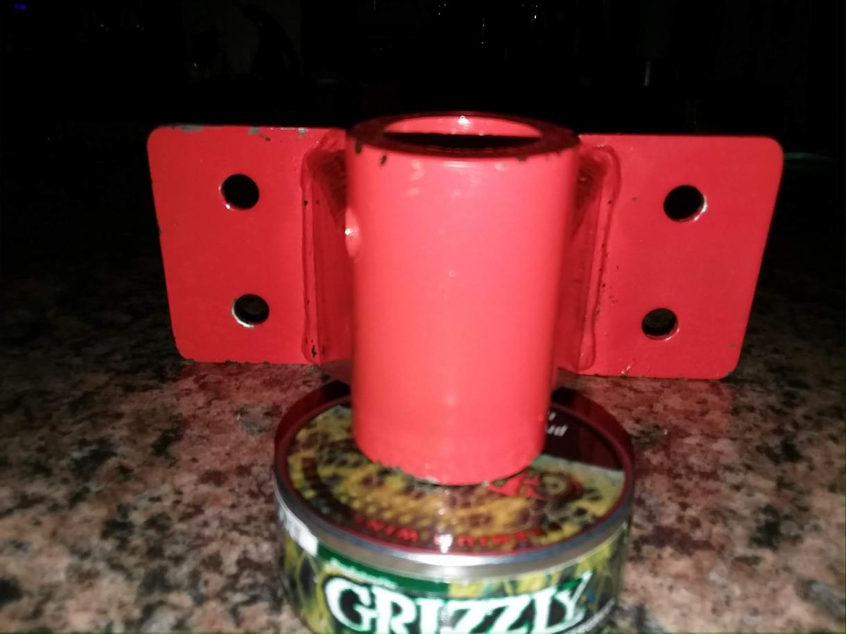

Purchased the replacement bracket today. $135 ..They told me they are side specific and they had them fabricated. I don't see how the right would differ from the left

I am also interested in a photo when installed... I broke off the wheel mount on one of my ZD mowers several years ago. I can’t weld to save my life, but that one weld was the only one I’ve ever done practically perfect.
My ZD mower manuals say the scalp wheels should be adjusted to 3/4” off the ground when the deck is lowered to the cutting position. I would imagine you would mount the new bracket with the lower edge of the hollow shaft at the same level as the other side.

I purchased the mower from Allegheny outdoor power equipment. They closed last year. Now I have to drive to Washington, pa for parts and service.
As for the other post about the deck wheels riding on the ground, the answer is no. Manual says 1/2 inch clearance. Guy at the part counter said you should be able to run your fingers under the wheel.
I cut the old bracket off with a sawzall and then used the grinder to remove the weld. Installed the new bracket. When I put the wheel in, the hole for the adjustment pin is in the wrong position. When you line up the holes, the wheel is at a 22 1/2 angle. The wheel would drag instead of roll. They told me since they had them fabricated, all the ones they have are wrong.
Hope to find time tomorrow to drill new hole in proper place. Will post a pic
