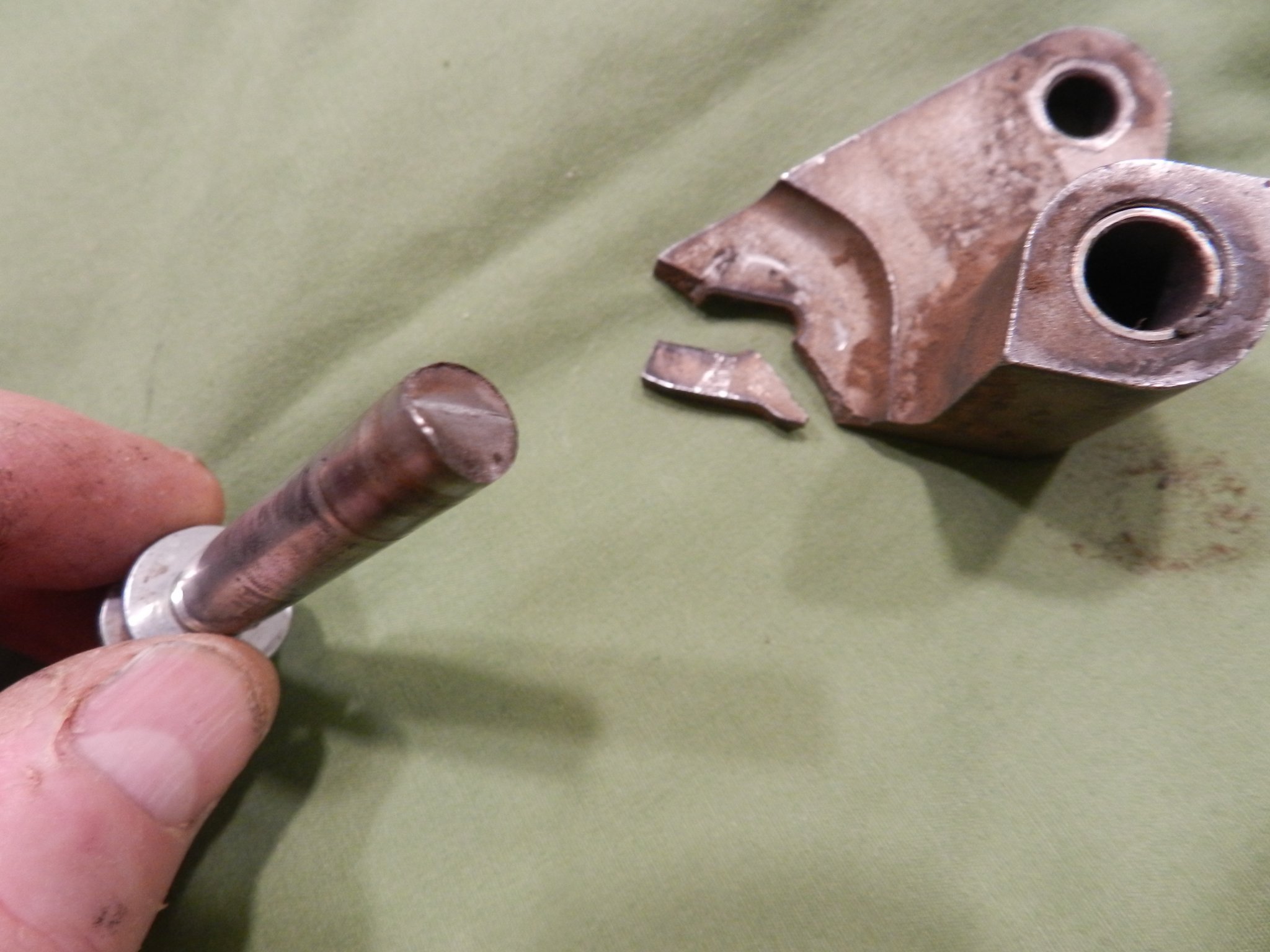

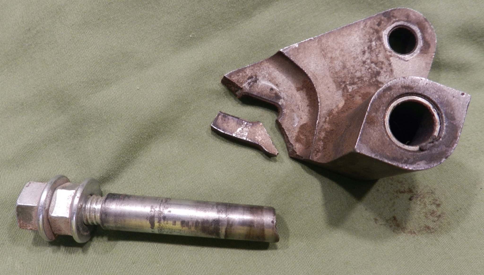

I previously posted an issue today I had with not being able to raise or lower the bucket on my BX25D. I believed it was something broke in the linkage and BX25DRookie gave me the info to get at the linkage. I took it apart and was rather surprised that the bracket and the bolt that connects the linkage to the hydraulic pump were both broken. I supplied photos of the broken parts. The bolt threads onto a bolt that looks to be welded onto the bracket. It looks like I have to remove the bracket that holds the linkage to the haudraulic pump and will probably have to drill and tap it out. It's not a small job as that bracket looks like it will be real fun to remove.
Has anyone ever come across this problem? I'm baffled as to how the bracket and the bolt broke and I'm really dumbfounded as to how the bolt sheared off. I may take this one in to get it repaired as I'm not really sure what I'm looking at to get that bracket off to get to the bolt repair. If they had just used a nut on the end of the bolt it would be an easy repair but the nut is welded onto the bracket so it looks like I'll need to remove the entire bracket and then drill and tap it. Any input from the experts would be appreciated.

I would just by the parts you broke.
Stay 7J612-61213
Spool arm 7J612-62880
You might need the pin and clip if you don't have them.
It will run you abouty $100 for both parts.
FYI: Those parts bolt to the Spool valve, not the hydraulic pump.

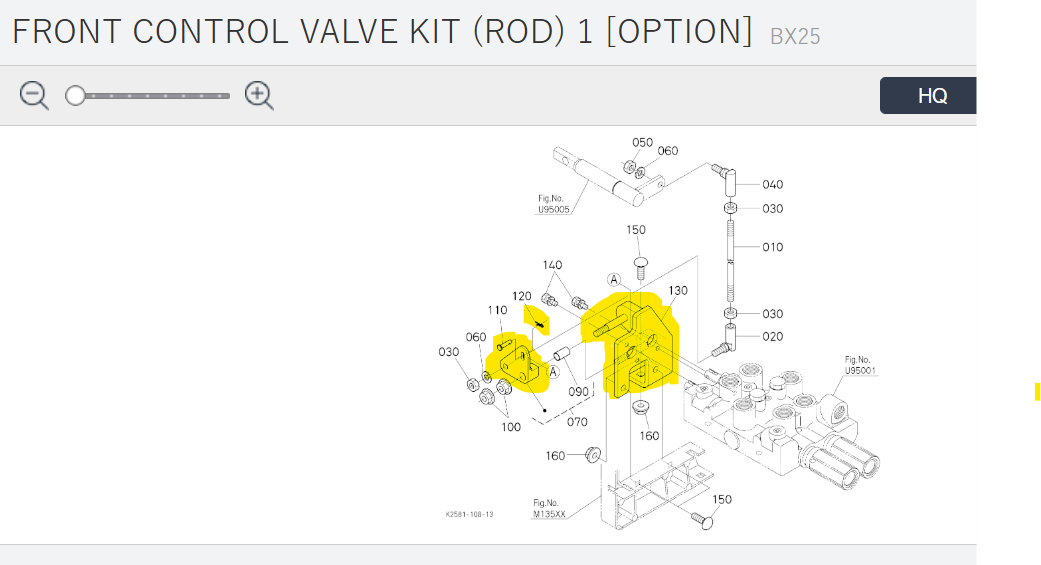

I did look at the Kubota website parts exploded view at/near the loader valve and could not locate a
part that looked like your photo.

Perfect response. Thank you. With the diagram I see exactly what I need. The bolt that broke is actually a stud and I'll need to order the #130 bracket as well and it doesn't look like a complicated repair (knock on wood). This is good as the service department said they are back logged for 3 weeks. I'll order the parts and make the repair. I operated the pump control manually and the bucket raises and lower so there is no issue with the pump. I had feared maybe there was a problem with the pump that caused the linkage to break but that is not the case. While I'm at it I'll replace the linkage for the bucket tilt control as well just to be safe.
Thanks to everyone that gave their input, it was appreciated.
]Anyone have this happen to them? it appears the stud broke and this caused the linkage to break. It just seems unusually that a stud like this would break. Thanks again.
