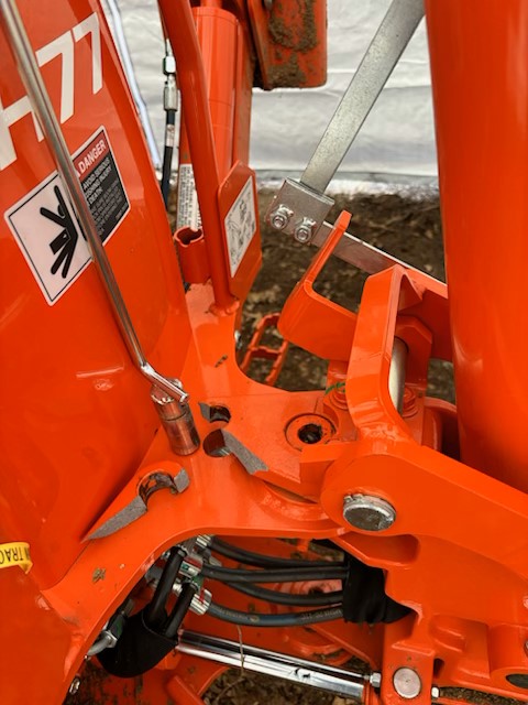

I just bought a new 3302 tractor with a BH77 excavator attached from dealer. I have only 8 hours on tractor, and have barely used the excavator. Yesterday this casting broke - its at the area where the safety pin is installed to keep excavator from swinging from right to left. Has this happened to anyone else? I have not abused the tractor in any way, in fact I am a new tractor owner and have been babying the heck out of it. Seems like a bad casting but wanted to see what anyone else thought? Thanks

No I didnt hit anything with it. Pin was in when it broke. I noticed a fair amount of wear on the pin and a fair amount of wear in the hole that the pin fit through. You have heard of this before? Wonder if its undersized or a defect in casting?

The pin fits in the casting hole loosely. I used the tractor for moving wood chip over some pretty bumpy ground for most of the 8 hours. The wear on the pin lines up with the lower edge of the casting hole and the casting shows wear in one location where the pin rests. I am thinking that the pin and casting wear is due to vibration and differential movement between pin and casting?

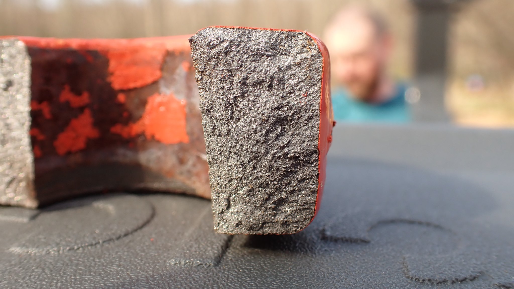

Here are some photos of the wear

Not a 'wear point'. At most, vibration over time 'might' cause the paint to 'wear off'. It is not a tight fit for the pin, in fact deliberately sloppy to make alignment (pin inserting) easy, the point is to keep the hoe from swinging on its' own. I only use the (other) one to prevent the hoe from drooping when parked.
I'll wager the dealer will tell you it was an owner error. I do not see anything on the casting that leads me to think it had a defect.
On the plus side, it is not critical unless trailering and even then, you can chain it to prevent movement.
Looks like a ductile fracture to me and I don't see any inclusions or other usual casting flaws. It's tough for me to determine if the failure was cyclical.

You were doing loader work over rough ground, by your description, for about 8 hours. With the pin in place, there would be a significant amount of leverage on that pin and the casting. From the looks of it, it's not a casting defect, but a failure due to overload. As suggested, the pin should not have been left in place. Whether Kubota will cover it, you'll have to ask.

2nd picture in post #10 shows a LOT of RUST on the inside of the hole. As it's an 8 hour old machine, WHERE did all that rust come from ?
Real curious about that !
Also the powder coat is all chipped in there as well.
