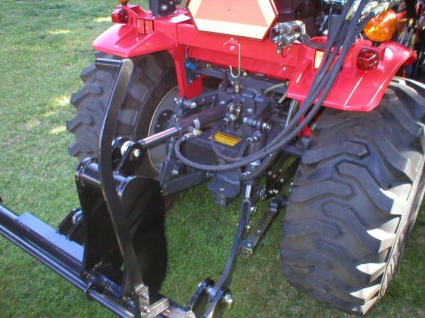

Top & Tilt hydraulic cylinders on a tractor 3pt hitch.
These increase the ease of the 3pt capabilities 100 x over. :cool:
