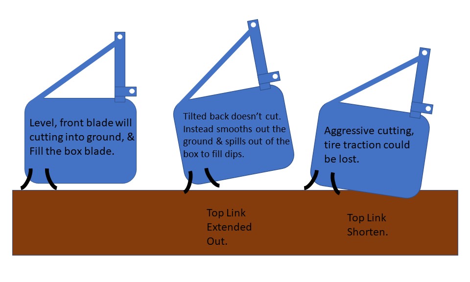

You'll make a mess with it before you figure out how to use it correctly.... You'll need to adjust the toplink a whole lot to learn how it works. You'll wish you had a hydraulic toplink much sooner than later....
^^^This^^^ But don't be discouraged.
What, exactly, do you want to accomplish with it? Your answer will help all on here with experience, and help you get where you need to be faster. It's not rocket science as you know, but a lot of trial and error time can be saved for you.

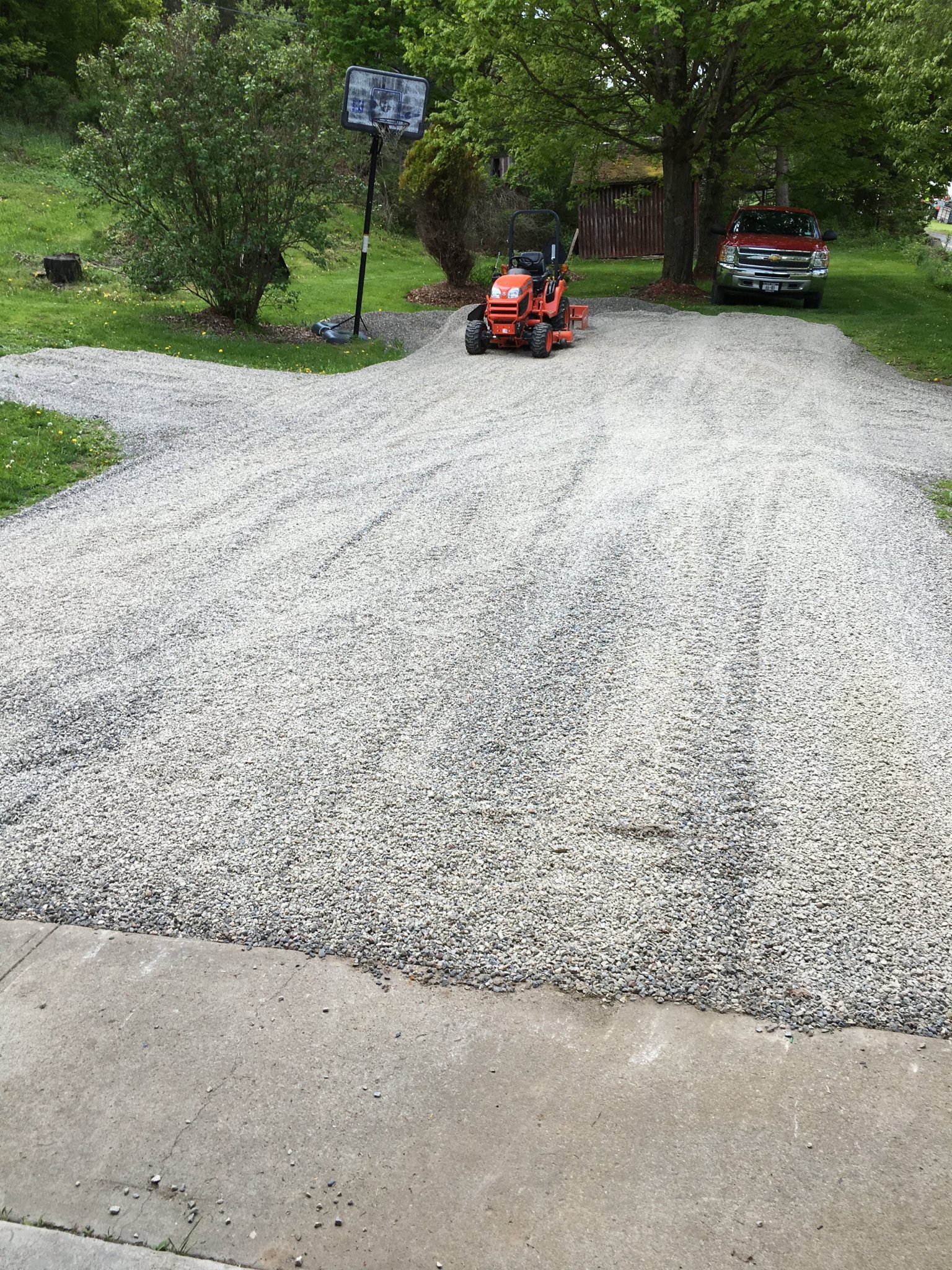

Every situation is different, however, I will point out my "mistake" when using mine for the first time.
I wanted to smooth out my gravel drive. There were some small, uneven areas developing.
So I put those ripper shanks down to "rough up" the surface, thinking that it would "speed up" the process.....
Well all that did was "pluck out" a sh!t ton of big ass, ankle breaker, rocks.
I should have just used the 'blade and box" to lightly go over it.
I got way to aggressive with it.
Don't be in a hurry.......Go slow, and take your time.
Thats my $.02
SOOOOO True!!! I just got a rear hydraulic toplink installed and it makes a world of difference. Some weight on the box blade, I feel, also helps with adjusting or feathering the blade/ground contact to get it to effectively do what you want. And you will most definitely screw things up on the driveway as you learn. The good thing is - it is gravel and easily moved back into place. I have 0.6mi of gravel driveway to maintain. I have found the box blade best for the heavy lifting of repairing ruts, spreading new gravel, and re-crowning. For the more frequent "dressing" of the driveway, I picked up a stout drag harrow that lets me quickly and easily smooth out the gravel. The box blade and drag harrow complement each other very nicely. Tines down to rough up and redistribute gravel and then tines up to smooth it all over.
