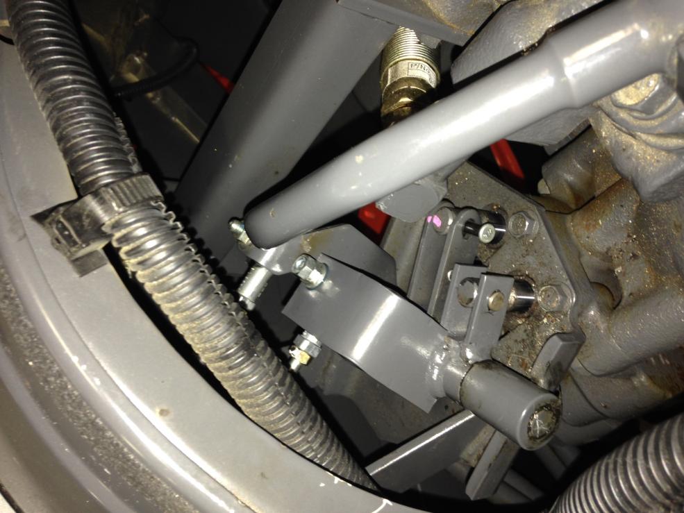

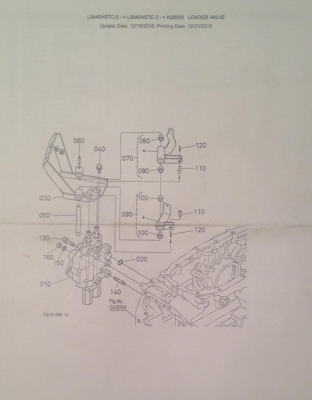

My boom lever failed for the third time this past week. Roughly every 150 hrs or so. While on warranty the dealer fabbed a brace on the part when it failed and we re-welded it the second time but this round we ordered a replacement. The best news is Kubota redesigned it to be a lot beefier. Ironically, the commercial snow company has the same tractor and his failed last week as well. I had gotten two replacement parts so I'd have a backup and loaned him one.
Part number is TD270-35482. Attached below in parts blow up see reference #90. Second pic shows difference of old part on right to the new one. Third pic is installed lever through access hole behind right rear wheel (wheel removed).
I think the blower coming out of float position has been my issue. Seems to come out pretty harshly. May need to have it checked or swing by a dealer and try another tractor.
