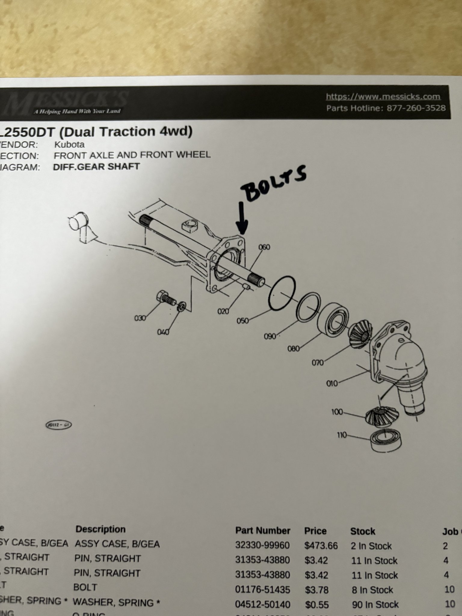

Bolting a L2550DT front axle assembly back to front wheel assembly case
plumber mechanic
Kubota B8200 with rc60-82h mower deck, Kubota L2550D
Sep 18, 2023
17402
I'm pretty sure I have an "O" Ring (see attached photo #050) that is causing a leak at the right front wheel. I have completely wiped the area dry and will be able to verify for sure in the next day or so. My question is when I bolt the main axle case back to the wheel assembly case (after replacing the "O" ring) do the bolts have to have a specific torque? Check out photo below.
