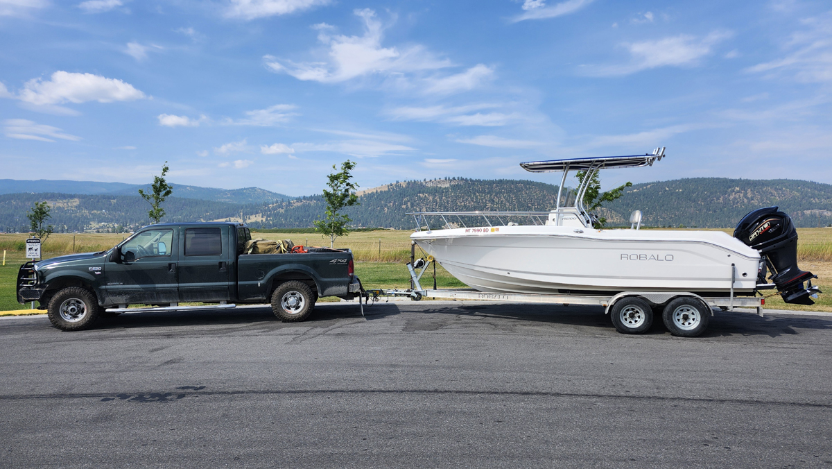

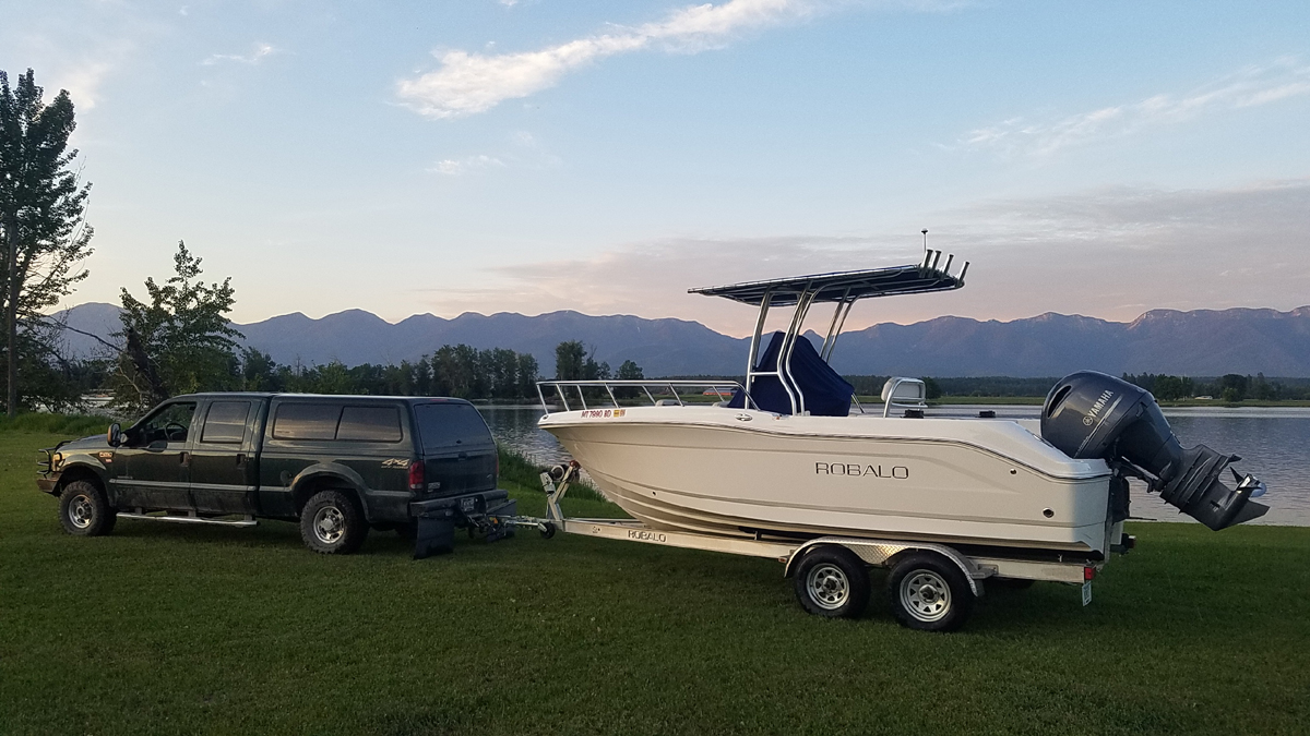

My boat is a couple of inches under 11ft from the ground to the top of the "rocket launchers". It's a 20'-7" Robalo R200 sitting on a Coyote trailer. The motor that was on the boat last year is shown in the photo, but I installed a VF200XB a few months ago. As you say, with the engine trimmed all the way in (down) there's a couple of inches clearance between the ground and the skeg.

Robalo R200 specs:
Bridge clearance with T-top = 8ft-4in
Draft = 15in
So using your formula we get 10ft-7in which is very close to the height of my boat.

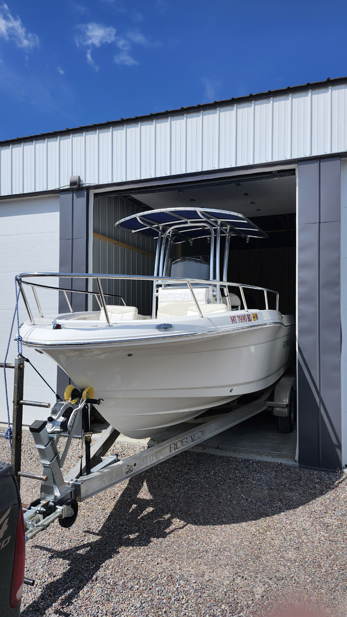

My real world numbers posted earlier are for my boat only. I put the boat into the storage unit this morning since I'm away next week. The door height of the storage unit is 12ft or thereabouts. Doesn't help you at all but it sure helps me to realize that I need a 14ft door once the radar is installed.
Good luck on your building and your boat ... looking forward to hearing more about it.
