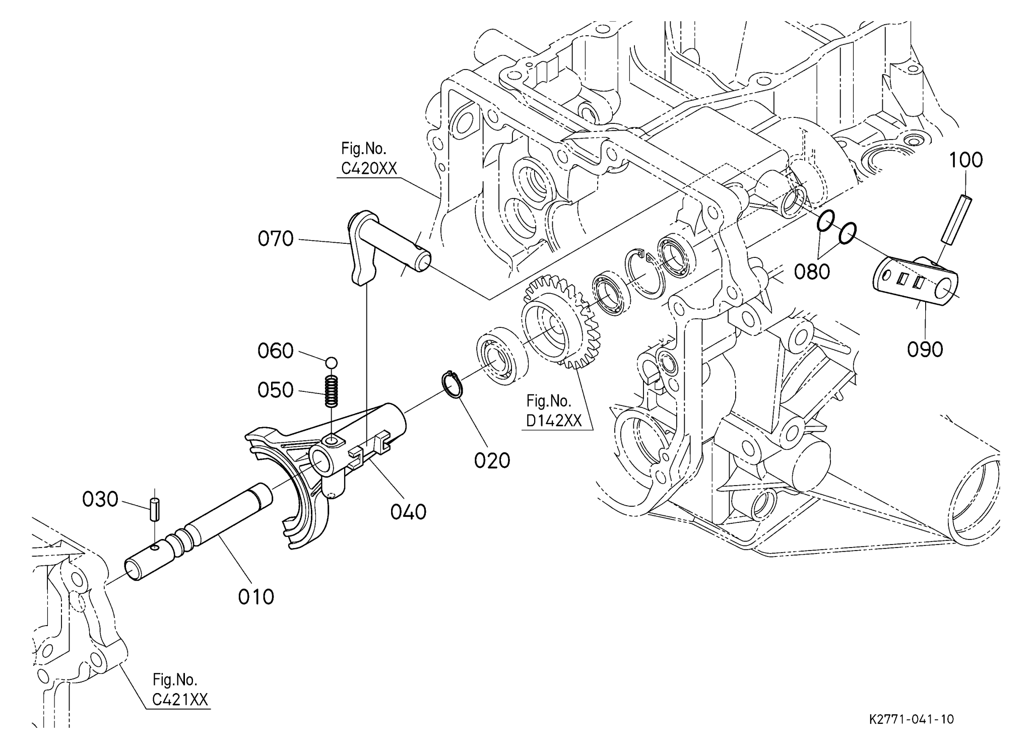

Seems weird that the lever has no tension - I don't see how that relates to hitting a root easily. Have you knocked the PTO select lever from mid-PTO to rear PTO or something, in your hurry to disengage?
I don't think those units have a shear pin, they rely on the belts to slip on the pulleys as a "clutch". At least that's how mine always behaves.

I reviewed the WSM and see no shear pins.
The Trouble shooting section for blades not turning says mid pto or broken belt
If the belt is not broken you need to determine if the mid pto is getting engaged, i.e. turning.
Start by seeing if the rear pto can be made to rotate.

Which lever, the engage/disengage lever or the PTO shaft selector lever?
The engage/disengage lever only controls a valve that sends oil flow to the PTO clutch pack.
