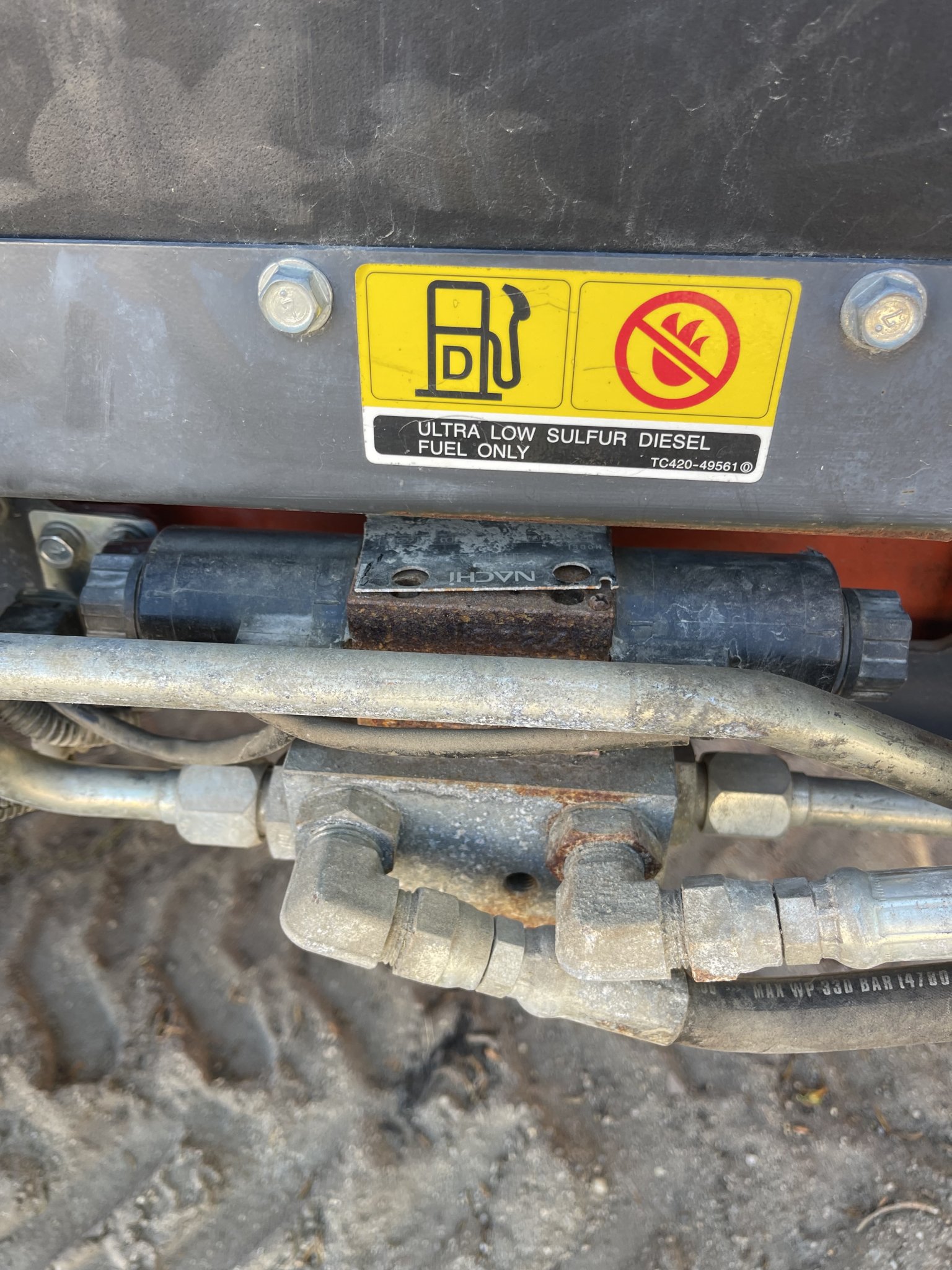

My used Kubota L4060 has a 3rd function added to it. It looks to me like the 3rd function hydraulics connect below the driver seat. I was wondering if I can add a couple of tees to those lines to use as the hydraulic feed and return for the hoe. That would be before the solenoid that activates the 3rd function.
What do you think??

No. You supply ths backhoe from the pressure return port on the third function valve. Post a picture of the third function valve connections so we know what you currently have.
