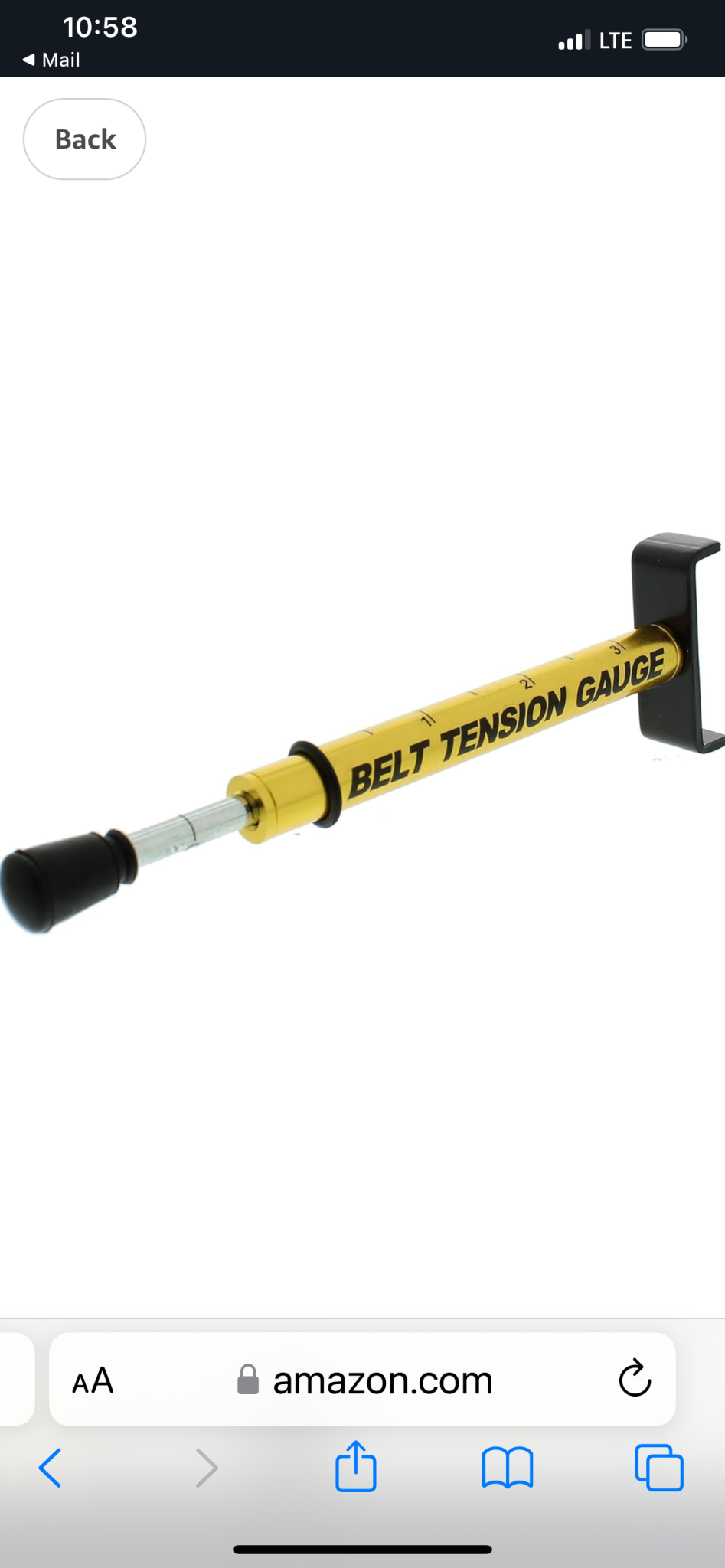

belt tension gauge for mower deck?
MAArcher
Kubota B8200
Oct 6, 2022
109
New England
Does anyone use a belt tension gauge for their mower decks? I'm wondering if the cheap amazon ones work. I only mow three acres with a good condition Land Pride 60" FDR2560 finish mower and I have to replace the belts two or three times a season. I haven't tried the $100 belts from the dealer, I've been using $20 belts from V-Belt guys and I just put on a D&D Power Drive belt and have a Dayco on the way as a back up. Hoping to find one that works.
I can't find any play in the deck and although there's some visible vibration in the belt at low speeds when I throttle up it seems to go away. The only think I can think of that might be causing the belts to where prematurely is that I'm not adjusting the tension correctly. So I'm hoping to find a way to precisely adjust to 7-10lbs of force at 1/4" deflection.

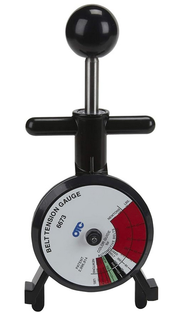

I have an OTC 6673 belt tension gauge that works well. I use it on my Jeep TJ mostly, and would consider using it on the Del Morino flail but I don't have a spec for belt tension.

The manual called for a quarter inch deflection at 7-10 lbs. I got a cheap 10lb gauge off Amazon and couldn’t believe how far off I was, way to loose. I used a square held against the deck for the reference point. Hopefully having the right tension helps.
