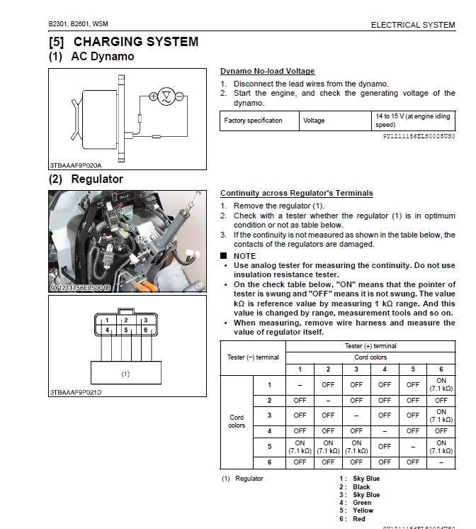

Your tractor has a dynamo. A dynamo is like an old bicycle light generator which rubbed on the tire.
The dynamo itself is extremely reliable. The dynamo will have two leads, usually blue. Set your multi meter to AC not DC , run the engine with the two leads disconnected and measure the voltage coming out.
It should be around 15 volts AC at idle and increase as engine speed goes up.
There is a series of tests you can do to verify the regulator.
Forum member lugbolt put together a great trouble shooting document which I have attached.
Before doing anything check the basics. Battery connections. Battery connection to frame. Fan belt driving dynamo.

I found the issue, mouse nest in the regulator plug and mouse pee corroded the red wire spade completely off. I looked up the part to finf the whole assembly is available but i wish i could just replace the spade that connects to red and slide it back in place. Where would i start looking for that kind of connector?

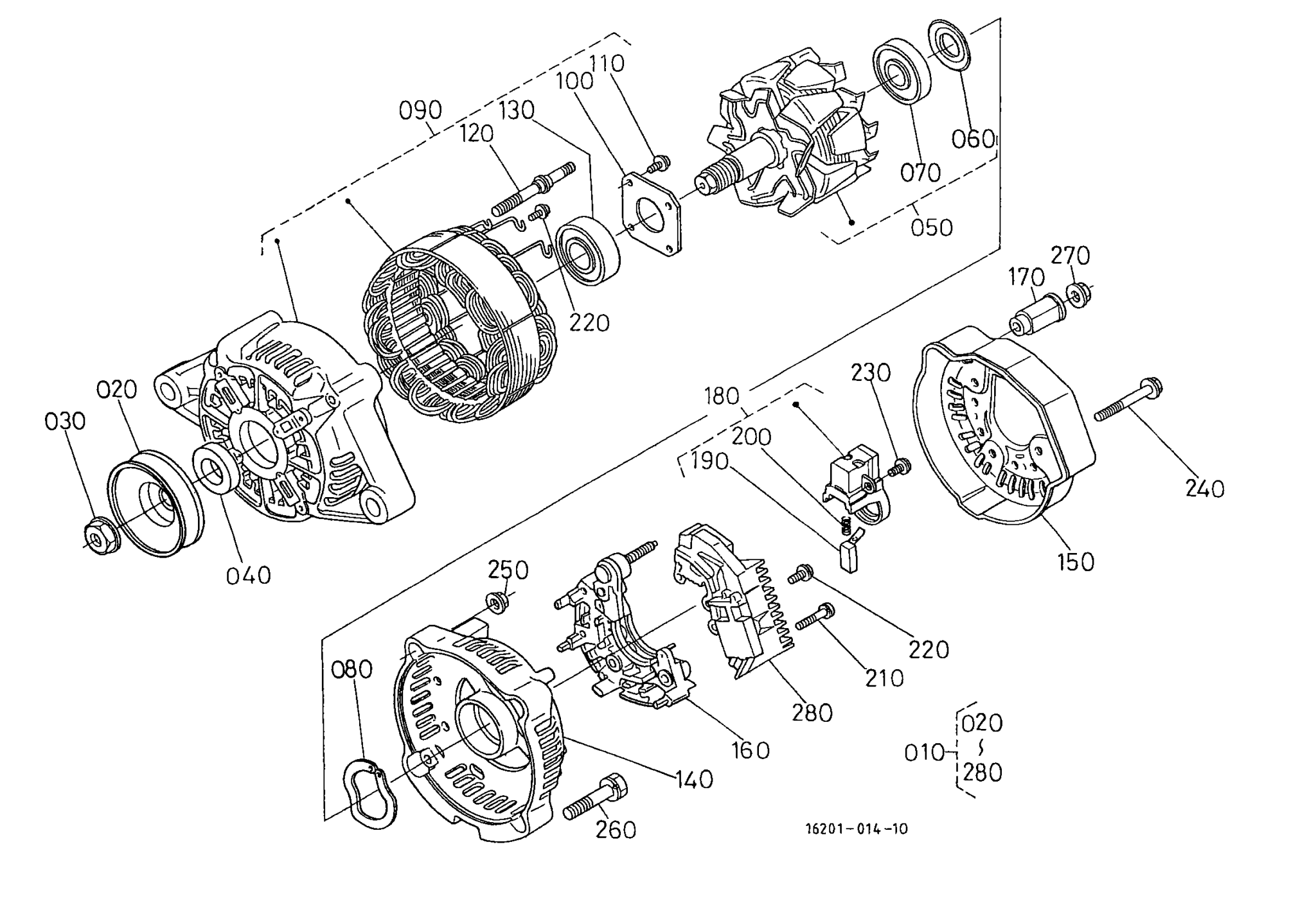

Maybe your nearest NAPA in Littleton, NH?
You do not have a separate voltage regulator. On your machine the alternator has a built in voltage regulator.
You have a problem but I do not think it involves your voltage regulator.
What is the part number of the part you looked up?
Picture please
