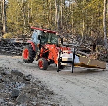

That's about what I did. Settled for around 700lbs (box blade + suitcases). The log I picked up maxed out the FEL at 20ish inches up. Rear stayed down.
