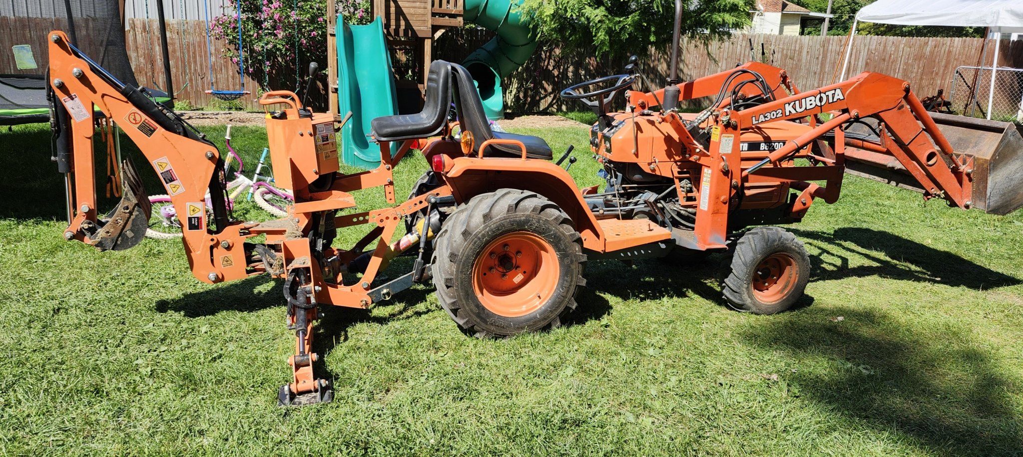

I finally found a used one it is a 2012 BHM95 model the previous owner had it on a small yanmar that he blew up and never fixed it came with a lot of extras fits perfectly and although little it works amazingly good for what I need .
Nice addition to your tractor and I’m sure you’ll love having it. I’ve got tons of use out of my backhoe over the last 22 years.
I don’t see the sub frame you mentioned earlier in this thread in the picture above. It looks like you’re using the backhoe as a typical three-point hitch backhoe. This may work fine for you as long as you own the tractor. Or you could end up cracking the transmission case.

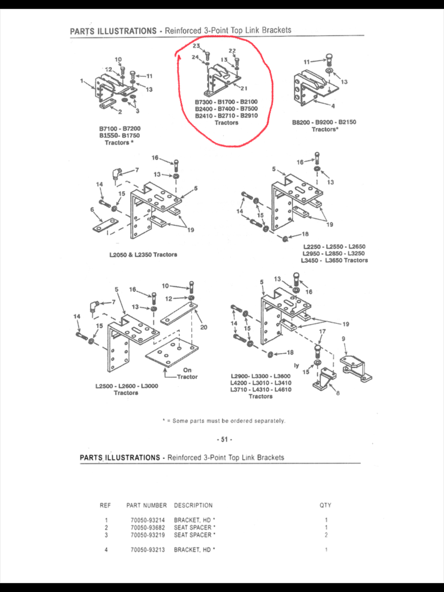

The following illustration shows heavy duty top link brackets Kubota sold for a number of different tractors. Please ignore the red circle. I don’t see your tractor listed there. Perhaps there was another page with other tractors listed. Don’t remember where I got this from.
Please don’t write off the need for a heavy duty top link bracket of some type. I recall seeing somebody fabricated one on their own in the past which I assume worked similar to the OEM bracket.
