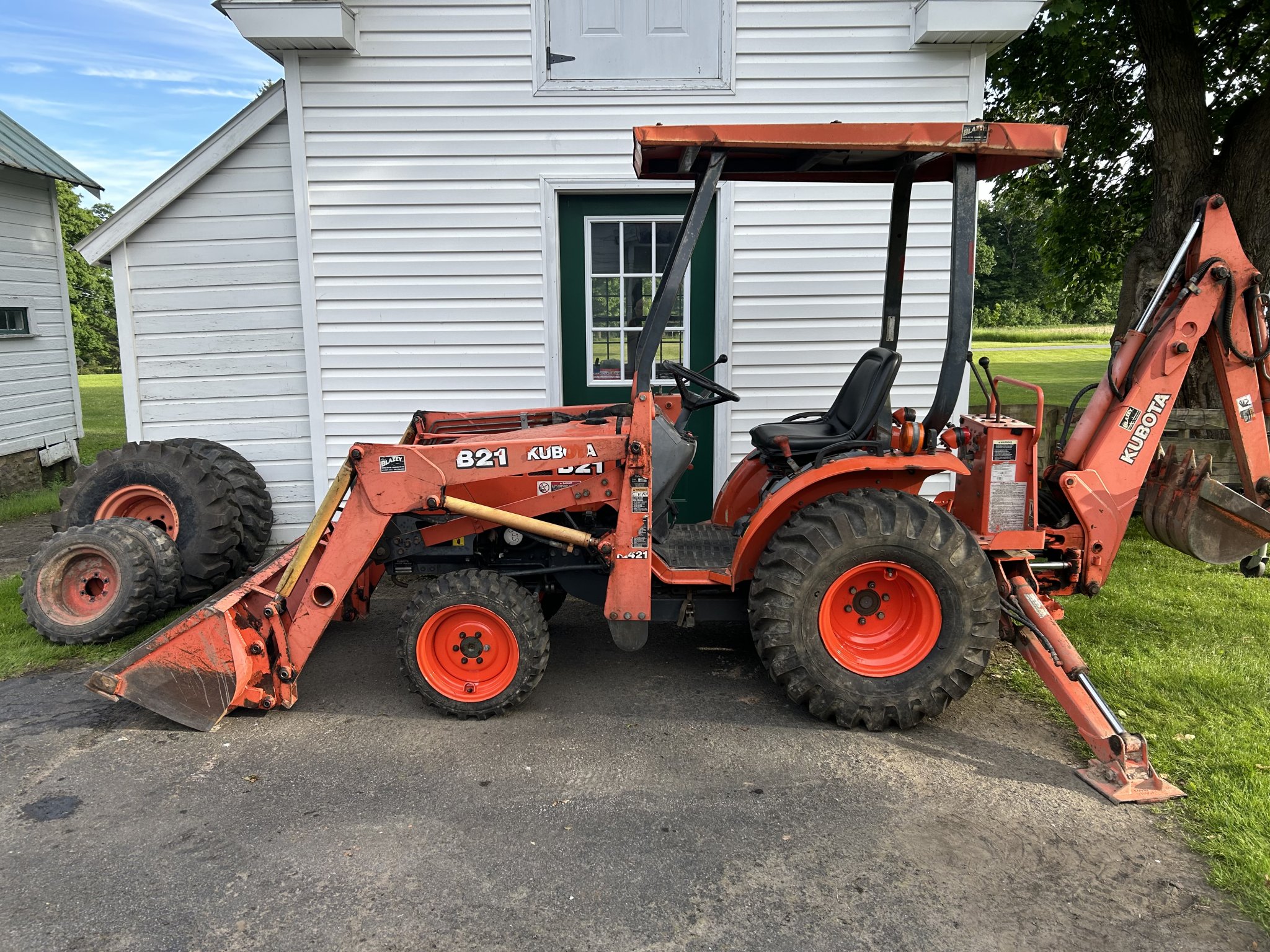

Hi All,
New to the forum and new (old) B21 owner. A good friend has a B7800 and swapped out his 87 hour industrial(?) wheels & tires with turf. Will they fit my B21? Sure looks like it to me, specs show the rears are the same, fronts a bit different? All 6 lug wheels, and all four are free to me. I do help him a lot, so not completely free.
Thanks, and looking forward to learning about my new machine...my first Kubota...

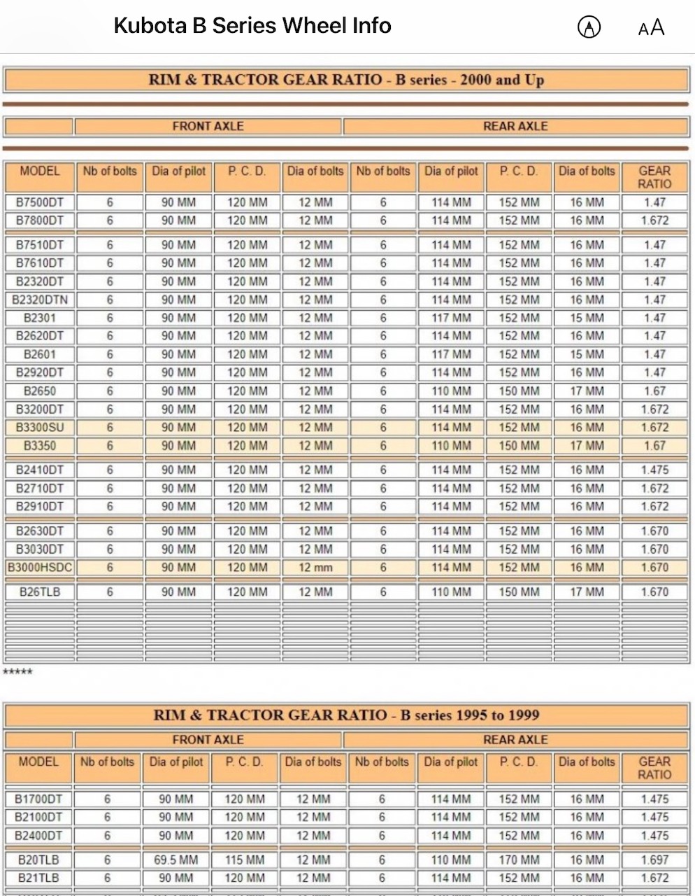

The above chart should answer your question…looks like they will fit and work fine. Gear ratio is the same for both tractors.
Edit: I’m not sure where I got this chart…

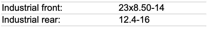

That's exactly what they are...the "new" ones anyway. Not sure what's on the machine now, as I wont have it for another week or so. I ass-ume they're OE's.

Since both to B21 and the B7800 have the same front-to-rear gear ratio of 1.672, OEM tires off the B7800 should work fine on the B21, regardless of what you find on the B21 when you get it.
