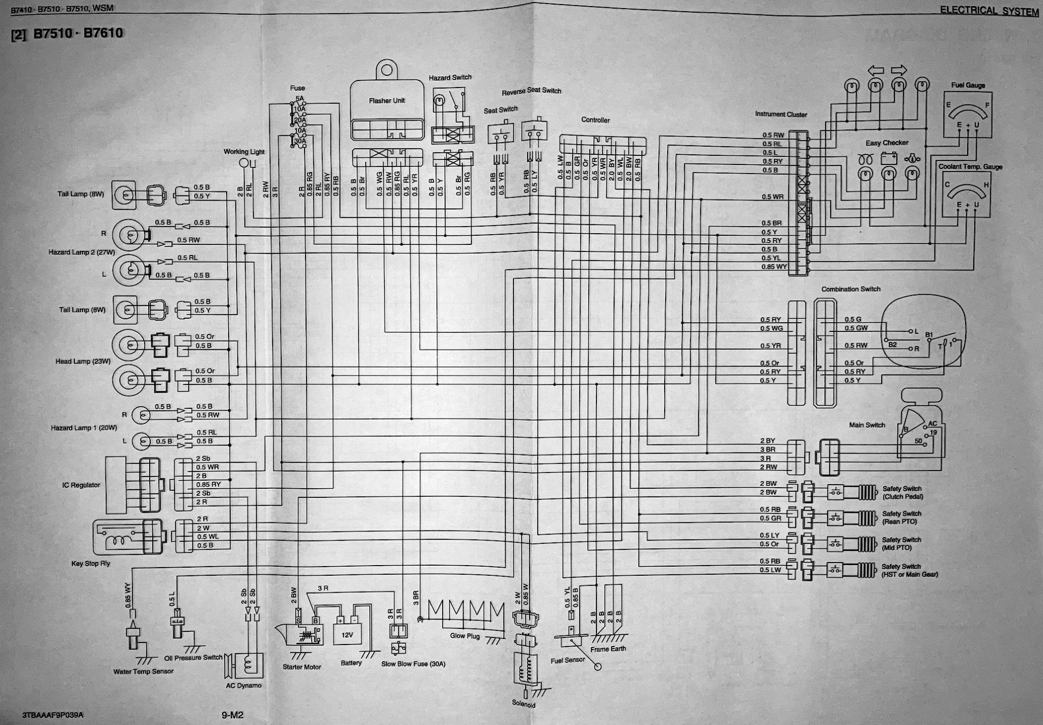

I have a B7510 that I've put all new lights on the rear (they were broken when i bought it). I have red running lights at one position of the headlight switch, but no lights otherwise. the small yellow lights off the roll bar don't work, the big yellow lights on the fenders don't work, and the red lights only work on one position.
I can hear the turn signal flasher working, but I don't have any turn signal indicators on the dash either. i have checked the fuses on the left side of the engine (one by itself, the master, and 3 in one) and they are all good. I've tried looking at the wiring diagram, but tracing the wiring harness has been tough. Am i missing fuses tucked away somewhere?
This tractor only has 500 hours on it and is in near mint condition (besides the previous owner breaking all the rear lenses, except one. i'm not sure how to disassemble the dash so before I dive into tearing half the tractor a part does any one have any simple suggestions or advice?

You need a copy of the electrical schematic (found in the WSM). With that, you can trace out the circuits and repair them.
10,376
4,320
It'd be nice if you could post the wiring diagram ! There's even an 'electrical' subforum for them !!

The only way to find your issues (and you're on the right track) is to trace the circuit from source to bulb. No doubt it's a time-consuming chore.....

It sounds like it's in the wiring from the flasher unit to the dash indicators and hazzard lamps. The fact that you hear it operating should indicate you have +12V to the unit, and the on/off switch is working. Also, if the turn signal lamps and hazzard lamps share a common ground point, that should be checked as well. I would think your tail lights use that same common ground as well, so it's tough to say....

Sounds like your missing ground. Try to ground one of the lights independently. If it works then your on the right track. Trace the grounds in the schematic

i figured it out!
The key is the flasher acts as a relay and has 2 power sources. One directly from the fuse and the other from the light switch/turn signal. The hazard switch also has 2 power sources: The same fused source as the flasher and a separate one from the light switch/turn signal (light bulb inside the switch. So 3 sources going to 2 different thing-a-ma-gigs.
Once I figured out what got power from where I could see that the light switch/turn signal had power and the bulb inside the hazard switch had power. The shared fuse power is what was missing. I traced the wire and checked for a short to the fuse and it tested fine. The fuse tested fine and transmitted power. SO WHERE DID THE POWER GO!!!
As it turns out the fuse holder must have not been making a good connection with the fuse... Throughout the pulling out and pushing in a 100 times through testing it suddenly started working - intermittently. Did some digging and the connections were slightly corroded. Cleaned them up and it works just fine now...
I guess when I tested for power it was connecting enough to test, but when i activated the switch it lost it. Either way, I have jostled the mess out of the wiring now and it stays on consistently.
I've done my fair share of troubleshooting, but that was a royal pain. The schematics from the WSM have different colors that what I have - even though the wiring is 100% factory. Red/blue were actually yellow, brown was red, etc. Once I traced out the coloring problems it made more sense. I guess colors don't translate well from Japanese...
Either way, it works now. i have flashers for days in all configurations and they work in sequence with the hazards as they should.
Thanks everyone who chimed in. Hopefully this helps someone in the future... I only spent about 4 hours chasing my tail and translating colors.
