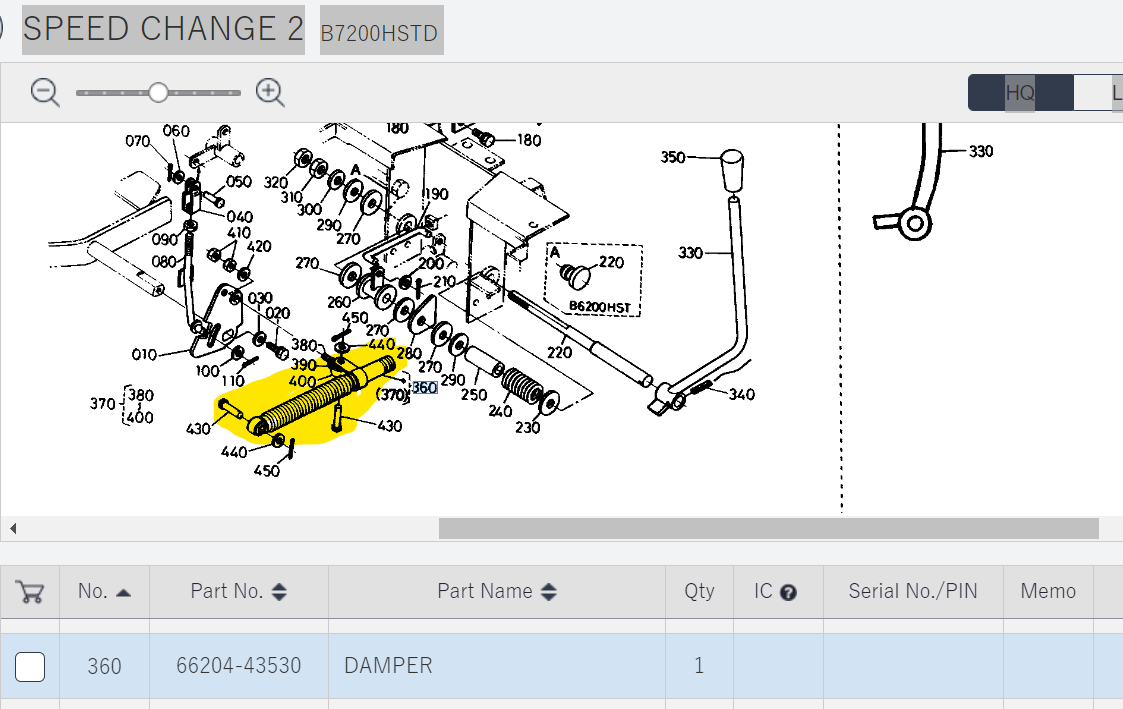

More than likely you have a bad dampener, that smooths out the HST control movements.

Check also the linkage on the side of the HST , the lever clamps onto the control shaft and may be loose ,, allowing the HST to over travel when you first push the pedal
