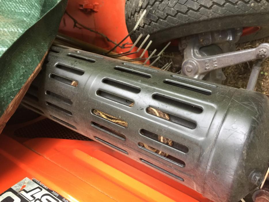

Can I ask the reason you need it? Are you trying to fabricate your own or just need a close up with measurements for comparison? I also read that you can switch the exhaust pipe to vertical but mine is still horizontal. I'm wondering if the German models might have been a little different than what we have in the states? I can measure mine and get pics though if you need it. Just trying to make sure of what your asking for. Mine has a baffle with holes mounted on the pipe. I'll include this photo which shows a snake that was in it the other morning...
