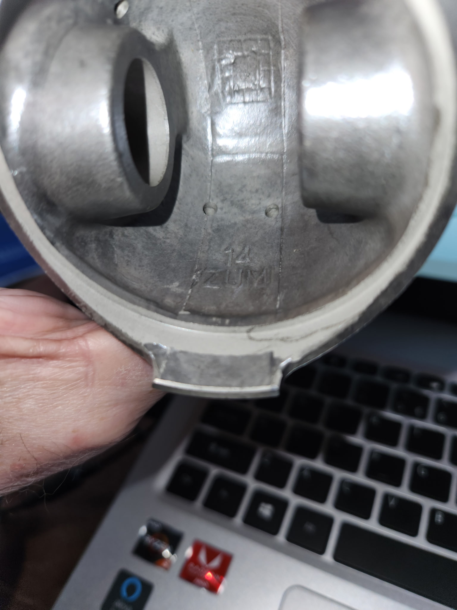

I am rebuilding the engine in my B7100. I know that the connecting rod is directional when installing but I do not see any markings on the new (or old) Kubota pistons. Attached is a picture of the bottom of the new piston which does have a number cast in one side and the opposite side is blank. Are they directional? Thank you in advance.

Thanks, I did read that before I posted my question. I'm not sure what Mr. Wolfman is referring to as marks on the piston.
Stock, old pistons will have a name / numbers cast into the inside those numbers go towards the injection pump side, same as the rods.
Aftermarket pistons very typically will have a stamp on face of the piston, I've seen dimples, letters, arrows they will either go forward facing or injection pump facing.
It could even be on a skirt, but that's rare.
If the new piston is in first pic, this mark goes towards the injection pump.

North Idaho Wolfman, thanks for clarifying. The picture shows the mark on a new Kubota piston.
