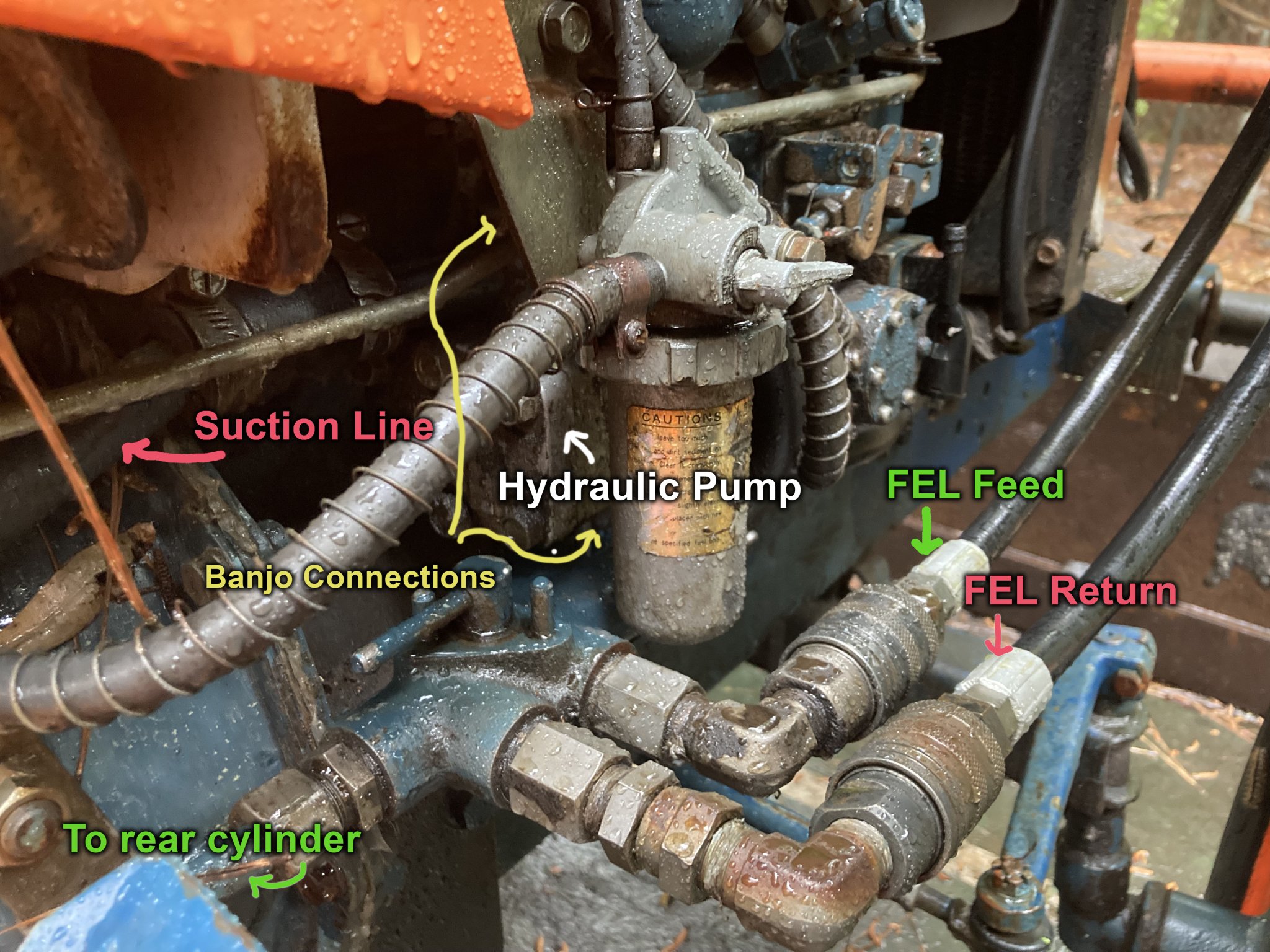

Yep, your dead heading the pump.
That's probably the reason for all the leaks too.
You'll need to provide some pictures and Hose / line routing info as to how the loader is hooked up because more than likely that's where your issue is.
A picture of lines with numbers on them is the best for figuring out what goes where.

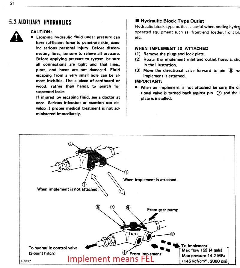

Please look at the following page from the Operators' manual and tell us if this is how your system is plumbed up.
Could you have moved the lever on top of the outlet block during your repairs?

I did move the lever (to clean the dirt off the control valve before replacing the seals on the banjo) and I may have left it in the wrong position. I assume this valve feeds both outlets in the "6" position and only the hitch cylinder in the "5". Otherwise i couldn't have used the loader and the box blade without moving the lever - and I never had to.
I am reasonably sure I tried both the "5" or "6" position after repairs but history has taught me I can't trust my memory so I can't swear it. It's pouring outside now but I'll try moving it when the weather clears a bit.
As for misconnecting lines, the only hoses I could possibly have switched are the implement supply and return lines on this control valve which connect it to the control block for the FEL. Rightly or wrongly, my thinking is that that would just reverse the direction I'd the lever to raise or lower the bucket. (Oh. I checked to make sure those were seated properly too.)
Otherwise, the only changes I have made to the hydraulic system are replacing two hoses to the FEL cylinders - and then one at a time and weeks apart so I couldn't have gotten those wrong.

Not quite. The B6200 has a main pressure relief built into the hydraulic outlet block which prevents over pressuring the pump.
The two line valve has an IN and TANK port. He is using TANK for power beyond. Poor choice but that setup still relieves out the TANK line which works just fine. for limiting inlet pressure on the valve as long as the down stream valve (3pt) is open to tank. In the event the tank line is blocked the pressure relief in the outlet block protects the entire circuit.

In this photo the outlet block lever is cutting flow to the loader.
Dave
8,205
4,128
Dave
Yes and that turns the loader "off".
With the loader's PB hose still connected it also back pressures the tank port on the valve when the 3pt is operated same as when the selector is in the "loader" position.

Reversing the supply and return will not reverse cylinder direction. It reverses flow through the neutral circuit in the valve and can cause all sorts of problems. I would suggest you reconfigure the couplers on the outlet block so that they are one male and one female to prevent accidental reversal of IN and OUT.
Here is how the hydraulic outlet block on the B6200 tractor works. I will also suggest you consider converting what you have to the proper power beyond type loader valve and plumbing.
