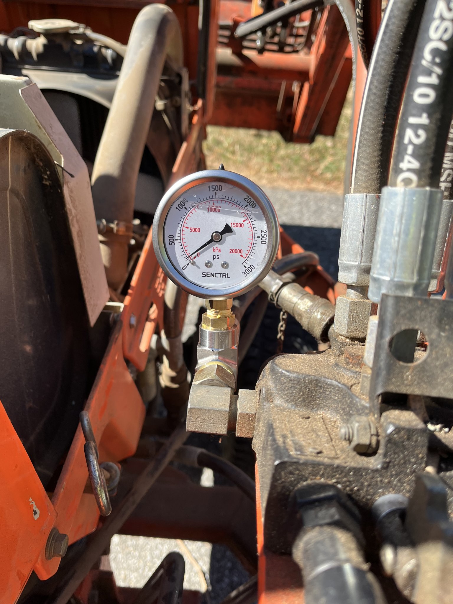

Yesterday I was skidding logs and had an issue with the hitch collapsing and not maintaining a set hight under weight. Not sure if the log I was too much. Wouldn’t have thought so.. however. I switch the lever on my block to bypass the fel and no real difference . I had the rpms up to operating speed- stood on the hitch and it went down. Now- I weigh 180 and it should hold me. I push the rpm’s up a little higher (3k) and it held my weight.
the control lever is sloppy; need to replace the bushing- not sure if that’s the main cause though. TIA
