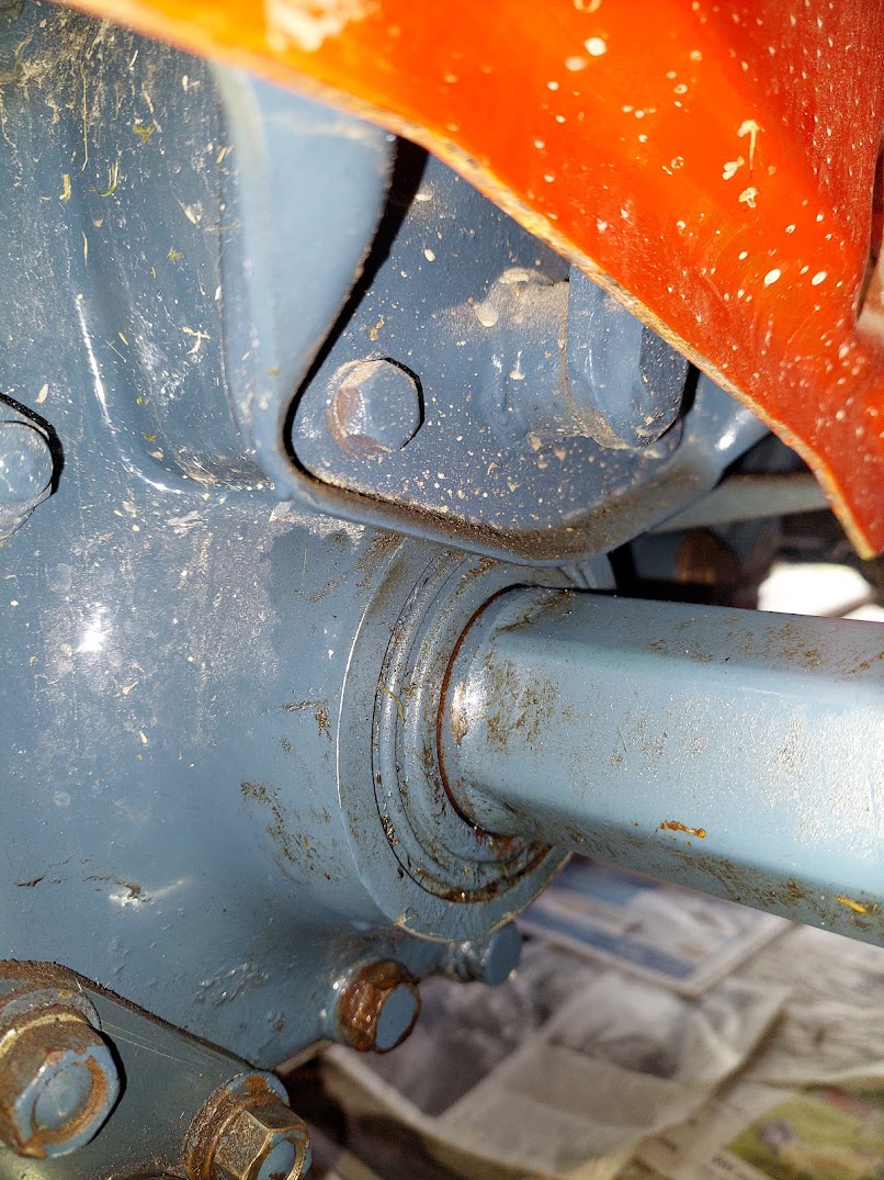

My B6000 is dripping some oil from rear axle seals, both side (~2 liters over the winter parked in garage). I got seals from tracpartz and was going to change them, but it wasn't like on B7100 like on youtube. I have to take off the blue cover on top of the seal (brake cover?), but is there going to be some extra steps? Can the seals be pulled without taking off the "bell housing" where the rear axle goes?
Also fan belt needs change, I think the engine must be lifted ~1 centimeter to get the new belt on. While in there, I got new radiator hoses + clamps for it too. Anything else what I should do while it's torn down?

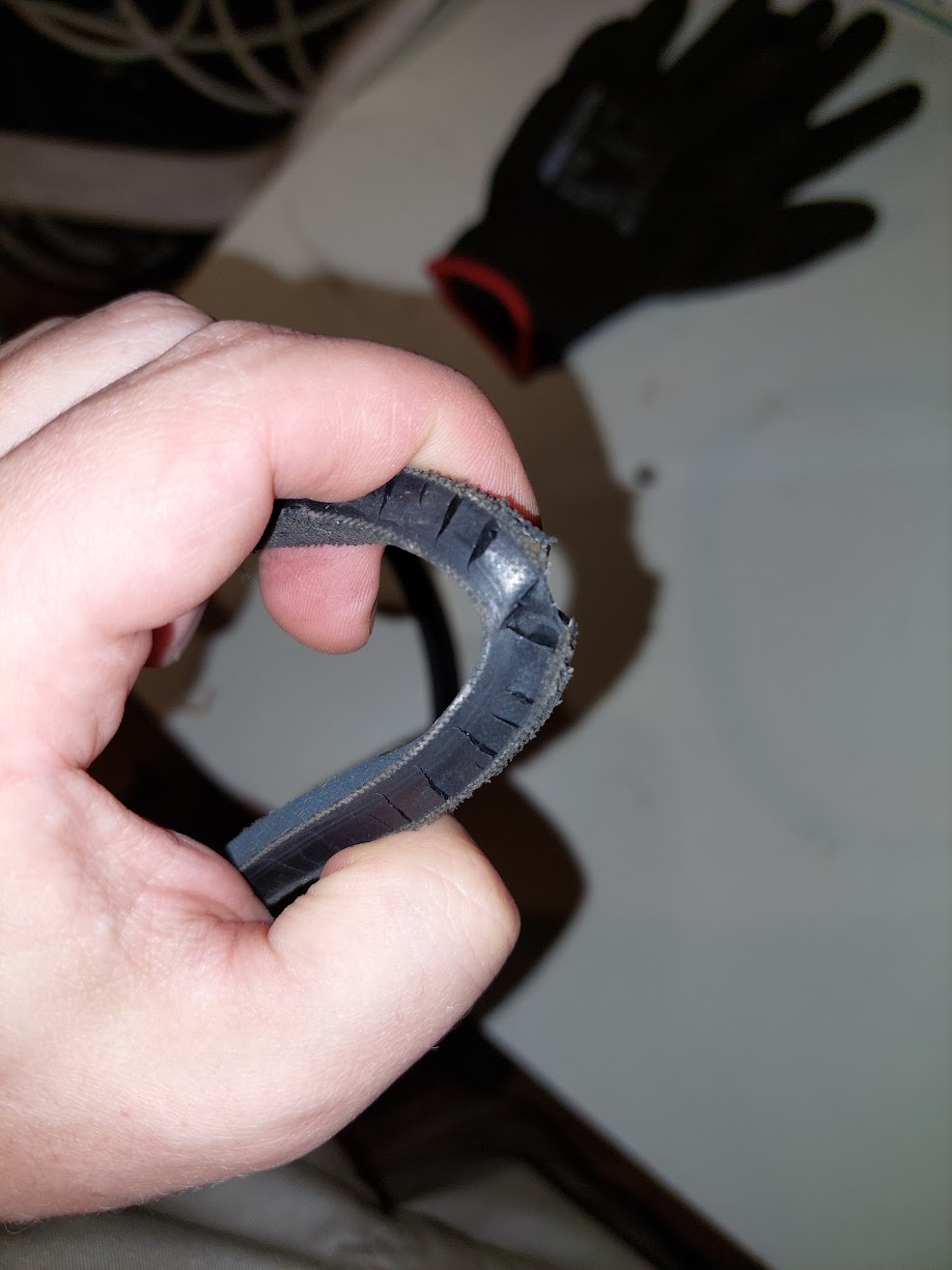

Got the fan belt changed finally and it was quite worn... I had to remove 8 of the 12 front frame bolts and loosen the rest 4. Then use a jack to get clearance between front frame and crank pulley to slip the old belt off and new on.
