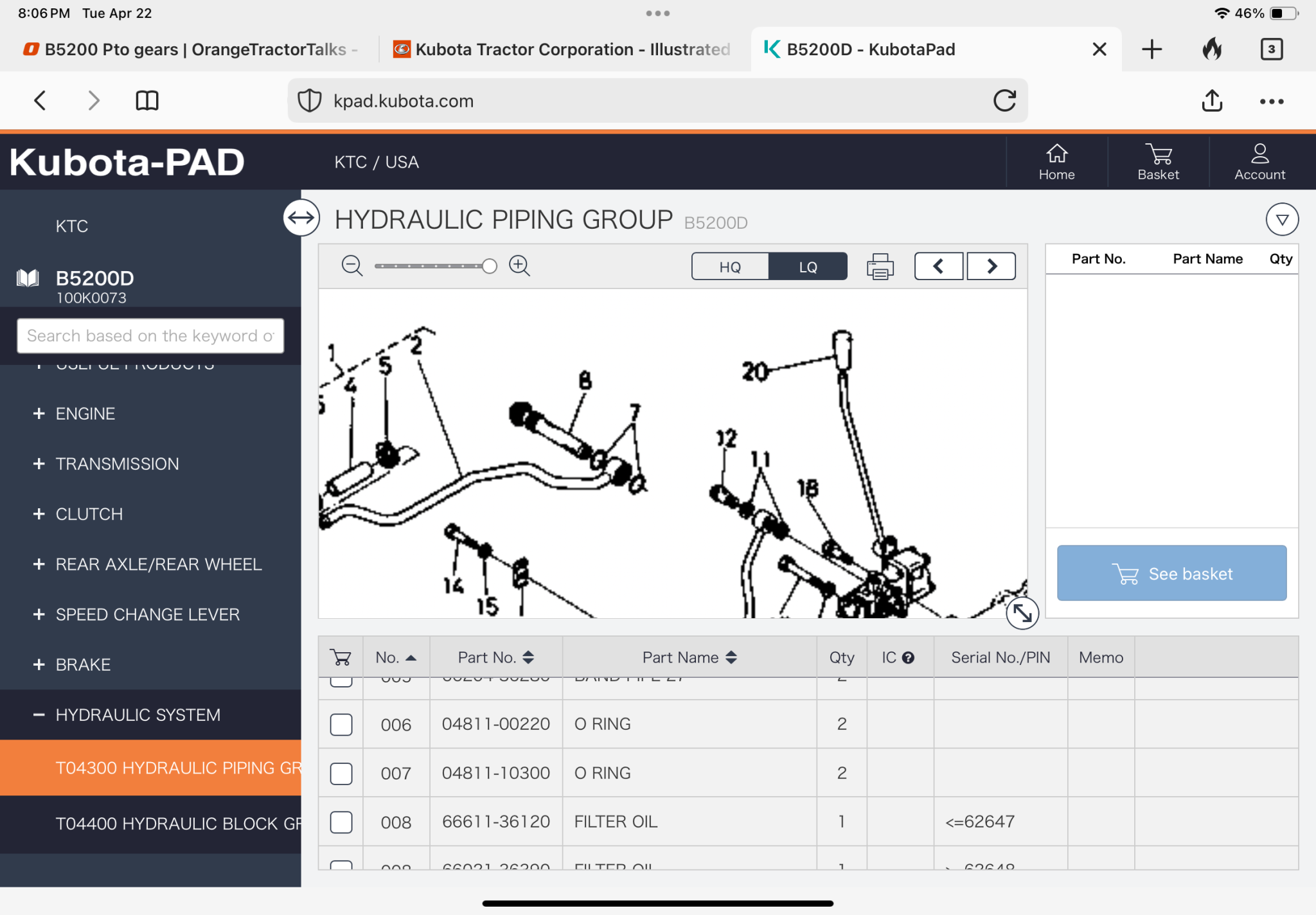

Wife was running tiller behind my B5200 and it developed a major leak. I removed the 6 bolts around the pto shaft and pulled to cover. I found the gear on the bottom shaft was missing a tooth. Top gear looks fine evidently the tooth got caught up and poked a hole in the aluminum casing. I think I can fix the hole with JB weld but need to find a replacement gear. Also how do I get the bottom shaft out to press off the bearing and replace the gear? Also need the part number for the gear if possible.
Wife is in a panic thinking she totaled her little orange tractor. All help appreciated.

All the parts for that are the same as a B6100, B7100
@Mountainman should have all the parts you need and he's close to you.
I sent him a message for you.
