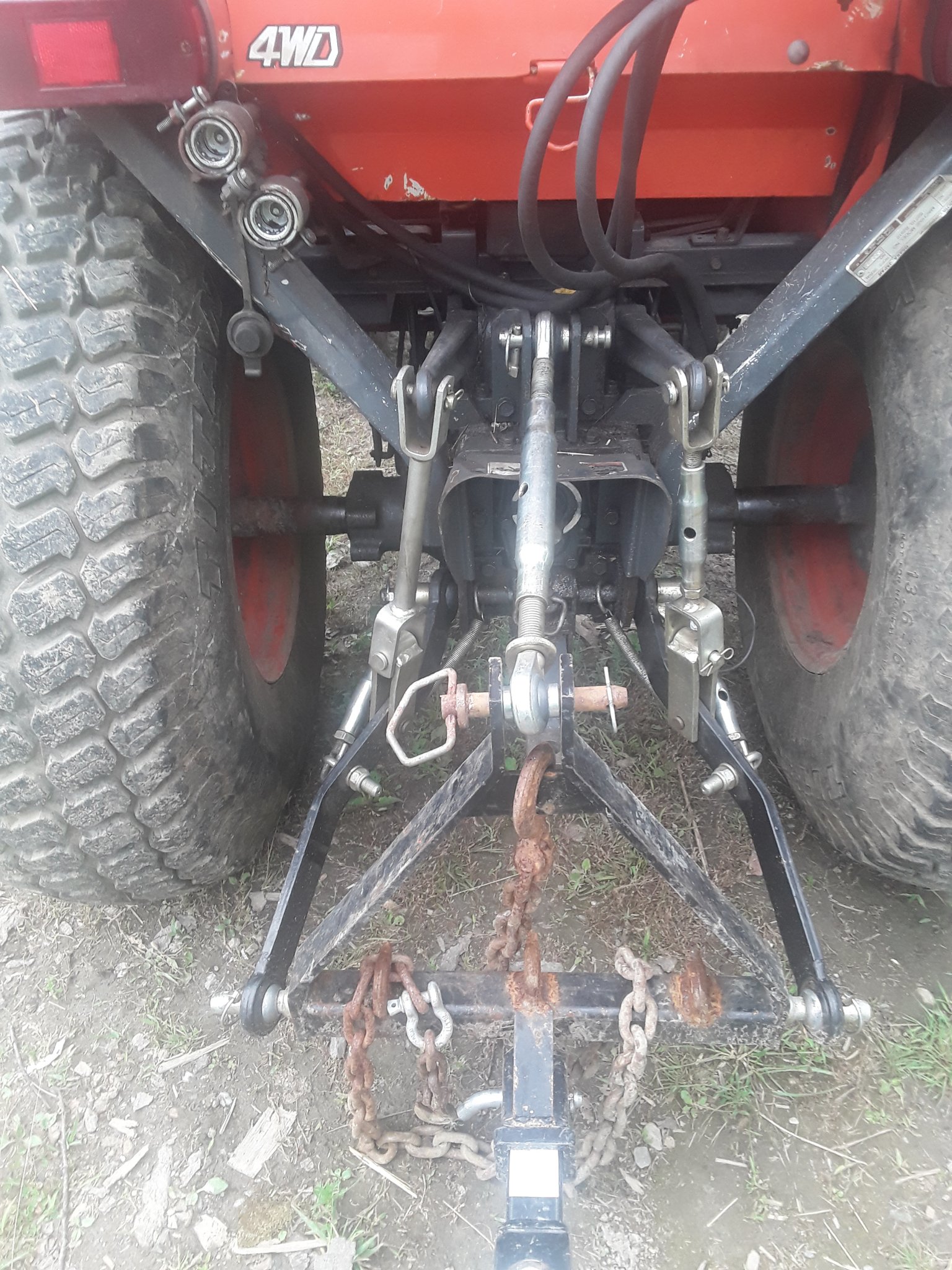

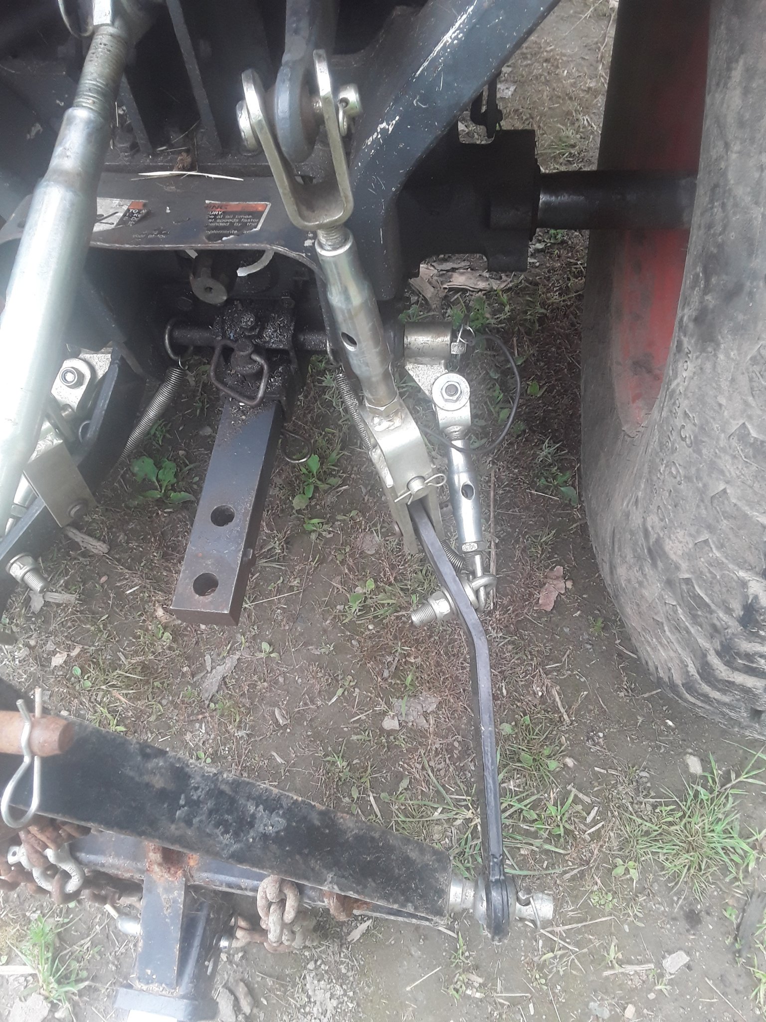

So I bought my kubota last fall had to put a fair amount of parts time and money into it. I've gotten it in pretty nice shape now. Went the other day hooked on bush hog. What is supposed to keep the 3pt hitch on tractor stable it has 2 turn buckles on on each side on bottem, but even with tighten all the way it has to much slack and when turning the bush hog actually can hit my rear tires... not good. Tried with back blade and yup it does too. I need it to be stable to use I have lots to do with ths 3 pt hitch yet. I have a ton of Bush hogging to do and clean up my sugar bush road with back blade any help?

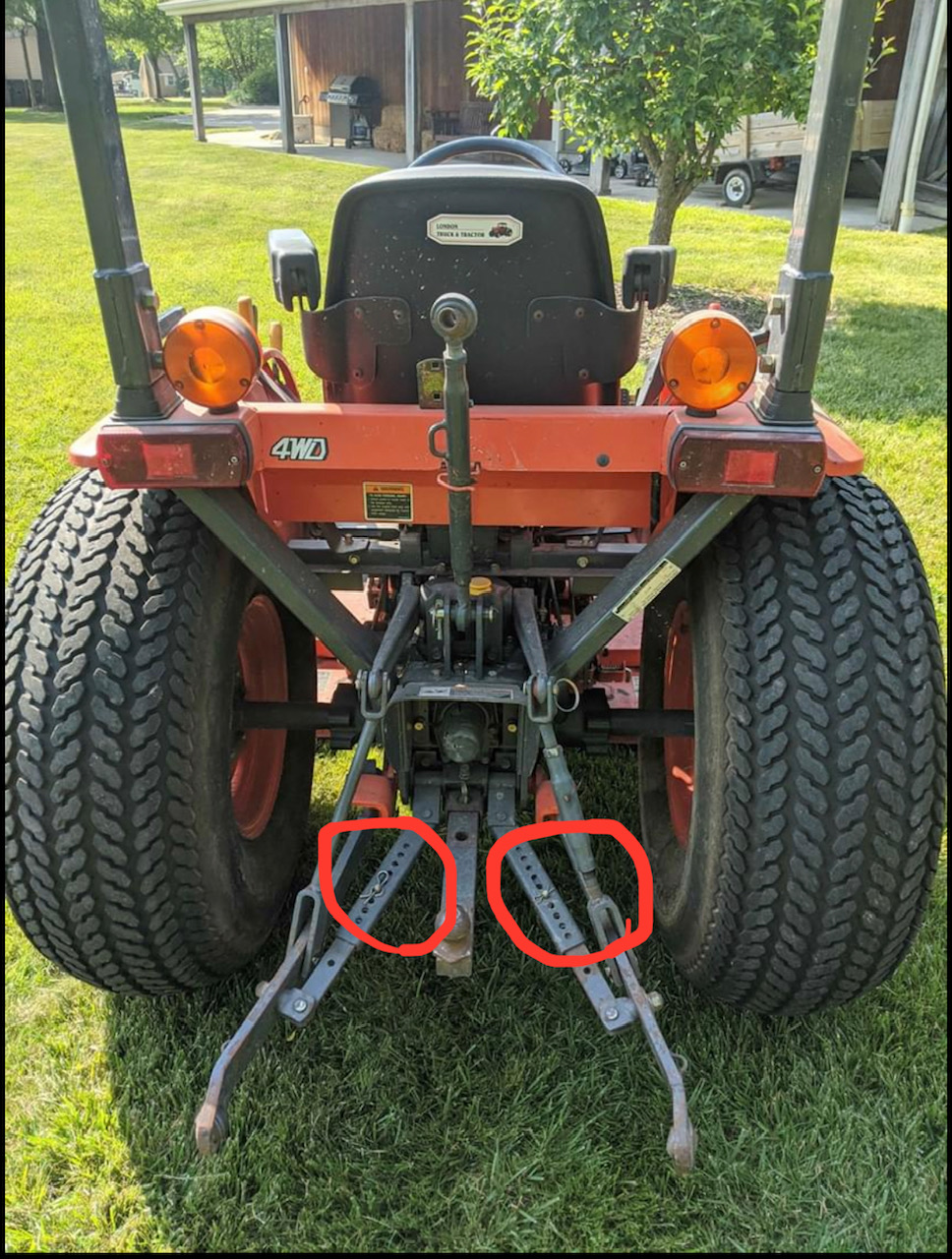

I have a B2710 and just got a brush hog this year as well. I noticed the same thing you are. There should be an area on your bottom links that has holes in it to adjust the length as the link sways side to side. I put a cotter pin in that hole and lock those links so they cant change length if they sway side to side. I'll try and find a picture. the pins circled in red are what keeps the arms from swinging into the tires.

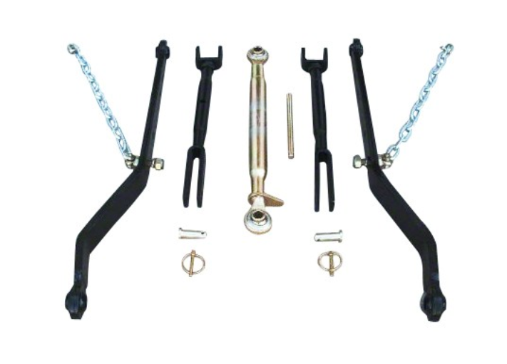

Are your lower arms offset like these? The offset arms give more clearance for the tires.

I'll try to get a pic of mine I'm guessing I need some revamping of mine caused it looks nothing like that lol

See what I mean I have my. Trailer mover on but i can sway that by hand too

Your tractor's lower arms are offset, which is good. Can you invert one or both of the lower pins on your implement to narrow the stance?
5,157
1,267

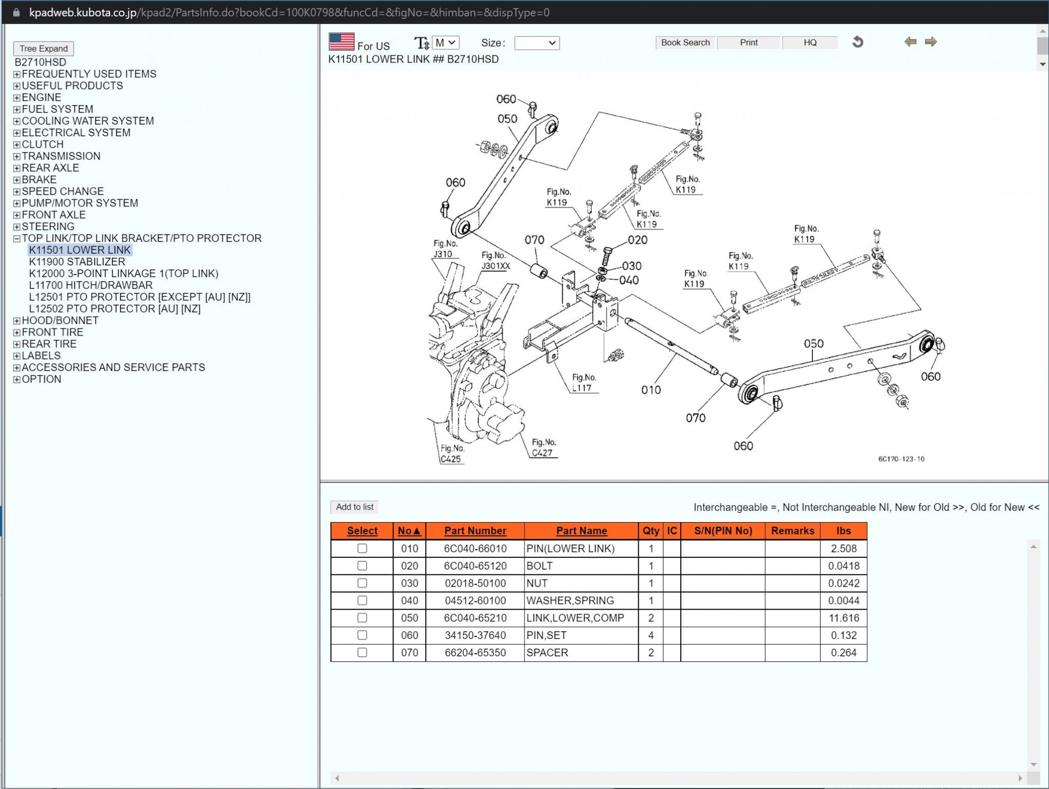

I believe that your arms and stabilizers are assembled incorrectly. The stabilization should be interior to the arms (looking at the pictures in post 4)
The part that fits on the rod may be on the wrong side of the tractor also but try to look at Kubota or Messicks for an illustrated parts list that covers the rear three point hitch
Sounds like the previous owner removed the telescoping stabilizers (expensive item at Kubota parts prices) and put turn buckles in their place...
edit: Maybe the PO actually changed the lower arms too...look at Jriedy85's Picture. Yours should look exactly like that. My B2910 does.

Might be an aftermarket kit.

I agree with Russel's post above. I really think that the lower trailing arms should be on the outside of the limiters.
Edit: just looked up you tractor. This is what you're supposed to have. Looks like the previous owner did some "customizing".

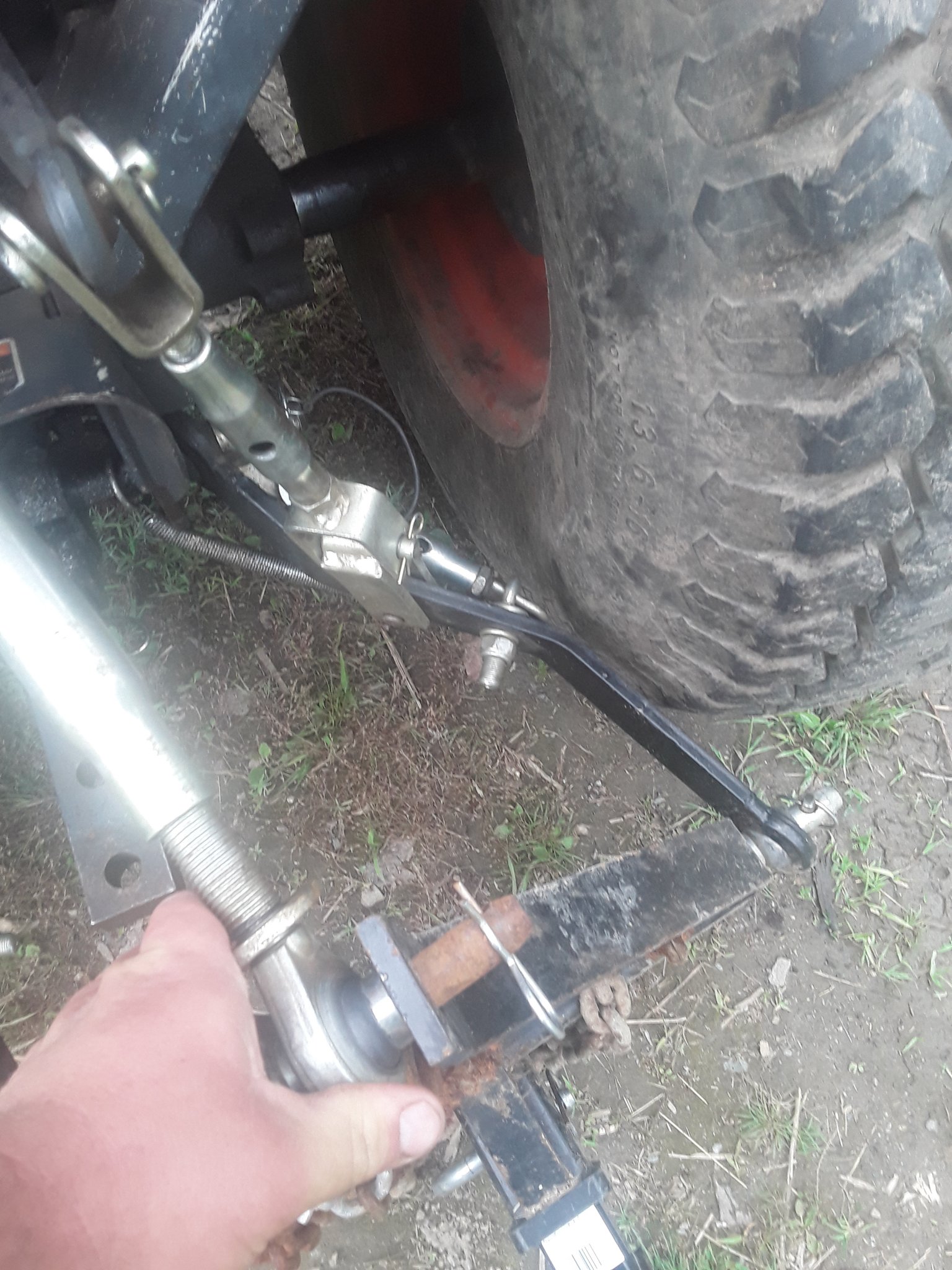

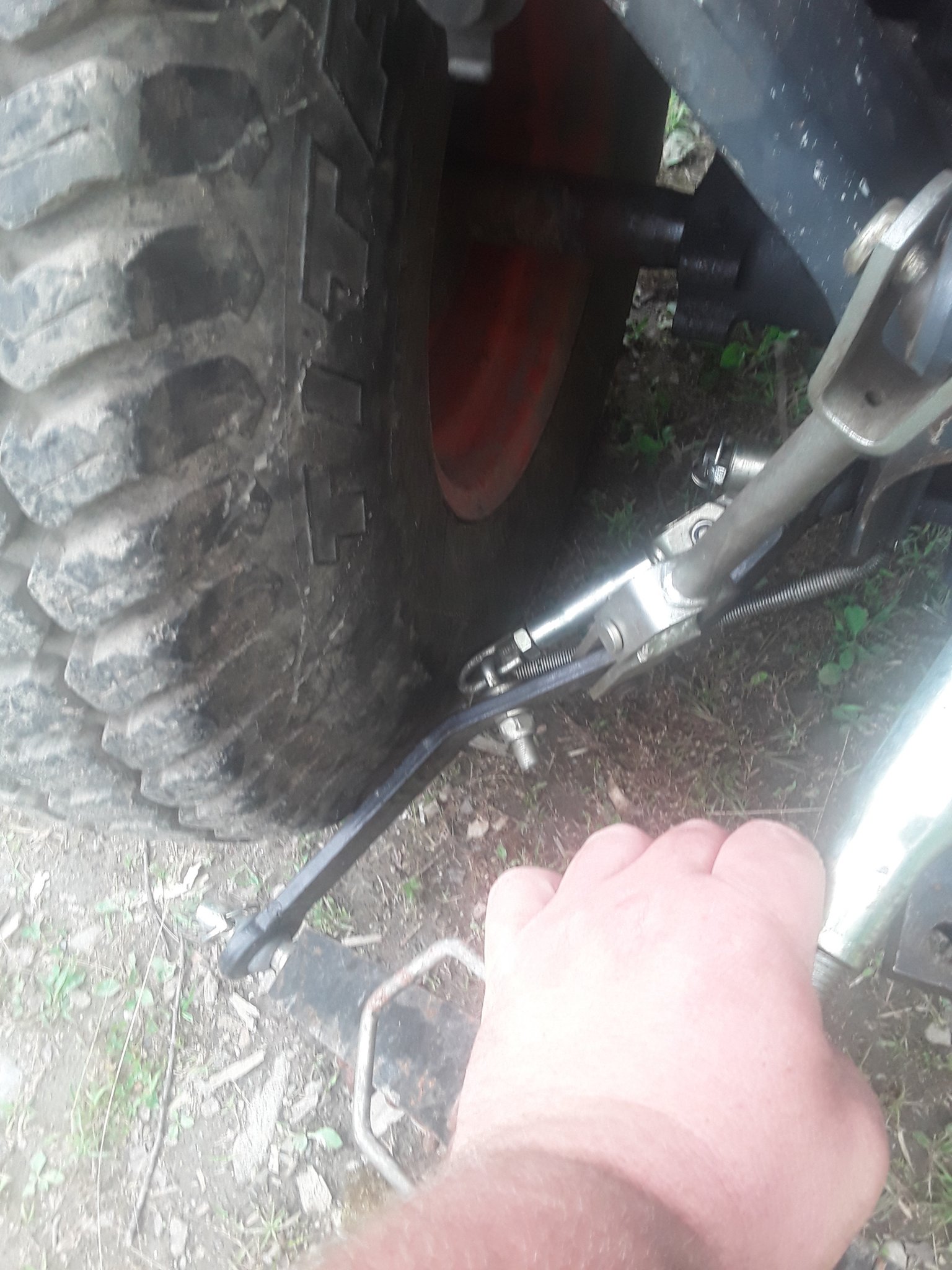

I did not realize those were pictures of your tractor above.
With the standard OEM 3PH the stabilizers are on the inside of the lift arms, and when you tighten them, you pull the lift arms in away from the tires.
On your existing setup, when you tighten the turnbuckles, you are pulling the arms towards the tires...what you do not want to do.
As an interim fix, perhaps you could extend the turnbuckles, rather than shorten them? This would push the lift arms away from the tires. But turnbuckles are better in tension than in compression for sure.
You probably want to reverse the turnbuckles, so they are on the inside of the lift arms, like the original equipment design. Then when you tighten them, they will pull the arms together, rather than apart. Looks like you MIGHT be able to do this without too much effort.
Also, if you can reverse the pins on the brush hog, so they point inward rather than outward, this will also help.
If that is possible and does not solve the issue, next step would be to compare the lift arms to the OEM arms, to see differences and perhaps come up with a final solution. One of us here could give you measurements to the bend, and what the angle is probably.

I agree with Russell. Something is not assembled correctly here. Also, the large amount of metal shavings below the PTO concerns me as well as an indication of improper assembly. Either the parts are wrong for the tractor or they are not installed correctly.
2,973
3,503
Good catch. I see it now as well. Almost like the PTO shaft is too long and its grinding the rear housing away.

Well I hadnt thought of that thanks so much. Also the shavings are the pto shaft which I have a part now on the bush hog some how busted spring and pushed to far onto the tractor shaft when I raised the bush hog. And rubbed on the housing. Causing shavings.
