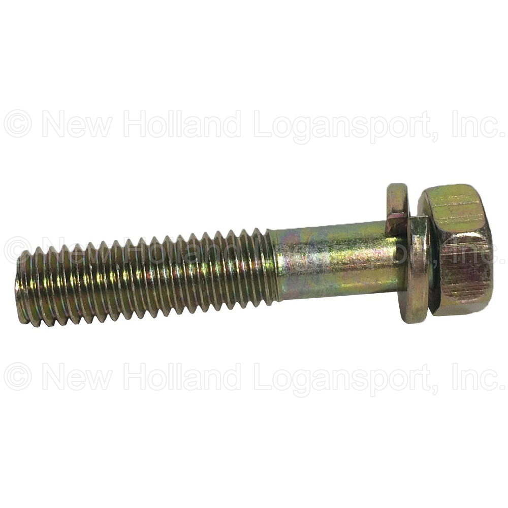

G gmbc Member Equipment B2650HSDC ,bucket, Forks, Front Snow blower, MMM, Tiller, Land Rake Mar 11, 2016 97 27 18 Dundurn, Saskatchewan, Canada Yesterday at 11:11 AM #1 Does anyone know the size of the starter bolts. Lost mine and trying to find locally. No Kubota dealer. I know ther are metric not sure what size and length
chim Well-known member Equipment L4240HSTC with FEL, Ford 1210 Jan 19, 2013 2,230 1,392 113 Near Lancaster, PA, USA Yesterday at 11:43 AM #2 ASSUMING I got it right, see below trail to Kubota M8x1.25x40mm Bolt Kubota Tractor B2650HSDC A52500 Starter Shop online for OEM A52500 Starter parts that fit your Kubota Tractor B2650HSDC, search all our OEM Parts or call at 888-458-2682 shop.kubotausa.com Kubota Tractor B2650HSDC A52500 Starter Shop online for OEM A52500 Starter parts that fit your Kubota Tractor B2650HSDC, search all our OEM Parts or call at 888-458-2682 shop.kubotausa.com Kubota M8x1.25x40mm Bolt Part # 01123-50840 BOLT www.newhollandrochester.com
