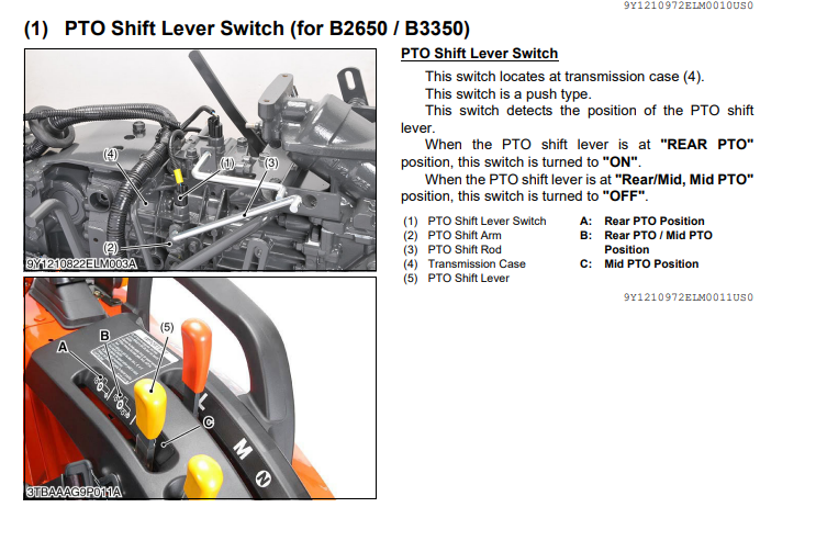

KubotaCool
BX1880
Apr 17, 2024
I think this should be the location of the switch. I would look to check it out.

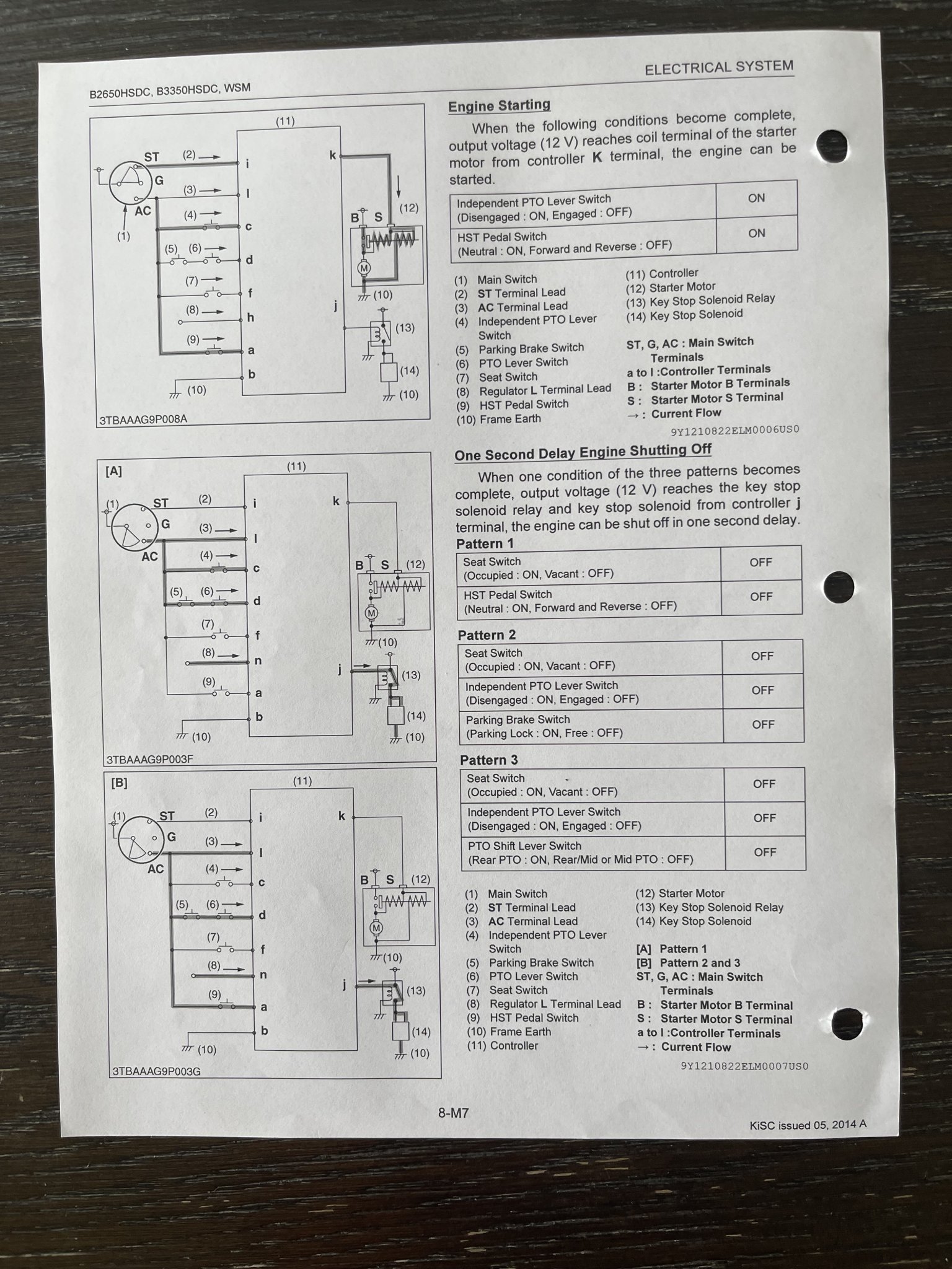

Lug66
LX2610HSDC, Z422KWT
Jun 7, 2023
80
53
SW Michigan
In addition to KubotaCool’s WSM picture above these extra photos should help you current and future troubleshooting. Unfortunately my WSM is older and lacks the color pictures.
