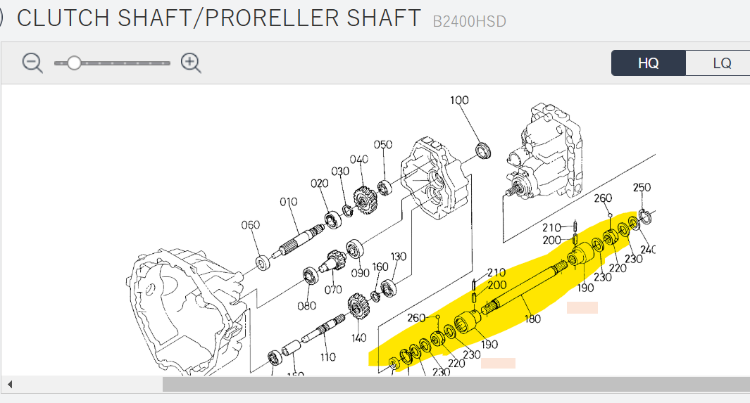

First thing to do is make sure the clutch is actually working and transmitting power to the HST and beyond.
And get the WSM (aka service manual)
Look do not touch and make sure the propeller shaft from the clutch housing to the HST is spinning.
Engage the PTO and see if it turns
If both are turning try moving the tractor one or both quit turning?
