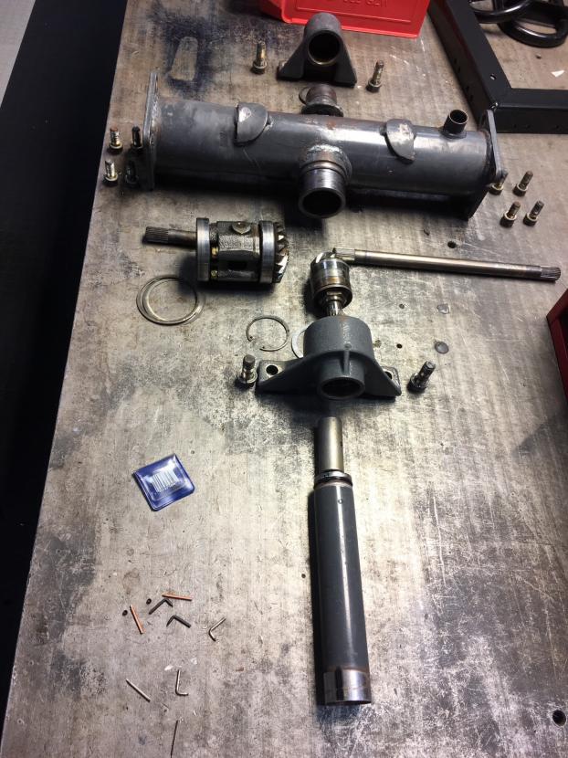

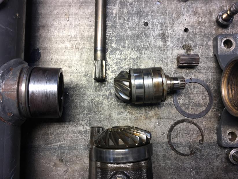

I finally made it back to upload some photos, some good news and some bad news. I didn't damage any teeth on the input gear but it did shear off the shaft so same results. I took the whole assembly off of the tractor, took it apart and then re-welded the housing. I found out that there was an issue with this style housing and the newer models/fix uses a cast housing.

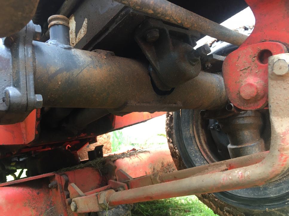

Here's a picture of the axle still in the tractor:

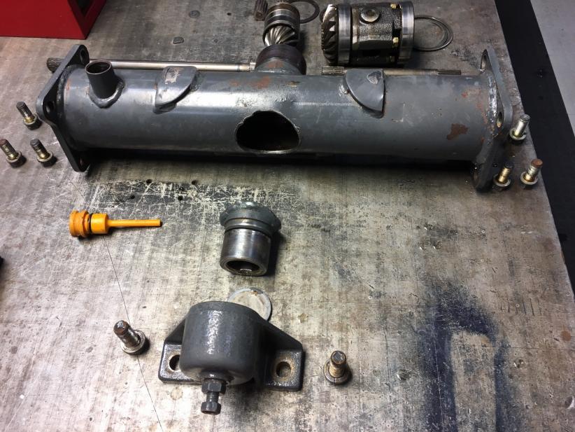

Here's another picture:
http://www.orangetractortalks.com/forums/attachment.php?attachmentid=30165&d=1499569087
The axle housing pivots on the two pins perpendicular to the axle. The pivot on the front is open so axle lubricant is able to leak out. That pivot rests in the front mount that has a solid washer that works like a thrust bearing. It is adjustable to account for wear. On the outside of the pivot there is an o-ring to keep fluid in. The rear pivot is the same but larger and it's thrust washer has a hole in the middle for the driveshaft to pass through with a seal that keeps the fluid from leaking by the shaft. There is a tube that inserts into the mount with an o-ring. I mention all of this because I have run across lots of questions about where these can leak from.

Wow. Not how I would have designed that. How about a pic of the shaft, if you get a chance?

Here is how i would approach it,order new stub shaft,make up a dummy plug to align broken parts on axle housing and fit and weld back together. Keep in mind it isnt the better cast housing and it will likely break without some substantial rienforcement.

Bingo, exactly how I would tackle it too. I bet it could be made stronger than prior too. I see a few parts welded onto the housing now, so its easily weldable.

The original welds are/were all garbage. They looked like earthworms crawling across the tubing. Very little penetration. I've already welded one of them and ground it down, I ground it done because I'm going to make a reinforcement piece out of steel, lay over the weld and weld it in place to for extra strength. It will look like a thick washer with holes in it. I will weld all the way around it inside and out and then weld the holes.
Yes the tube has a weird kink in it, when I first saw it I thought the tube was dented but when I looked down inside you can see that it is machined for the ring gear assembly. It is far away from the weld though.
