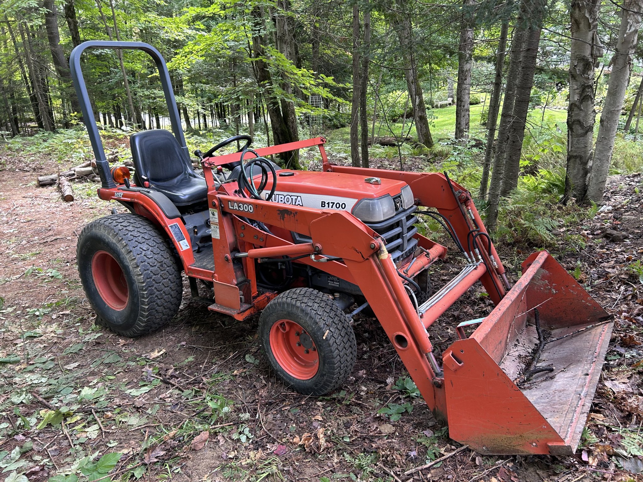

I have a new to me b1700 with 13HP at the PTO. Wondering what size blower I can use. I think 48 or 54 is the most ideal but considering 60 as there’s a good used one locally for a good price.
Will the little B1700 handle a 60”? Or should I wait for something smaller.
I’m in the snow belt off Georgian bay in Ontario.
