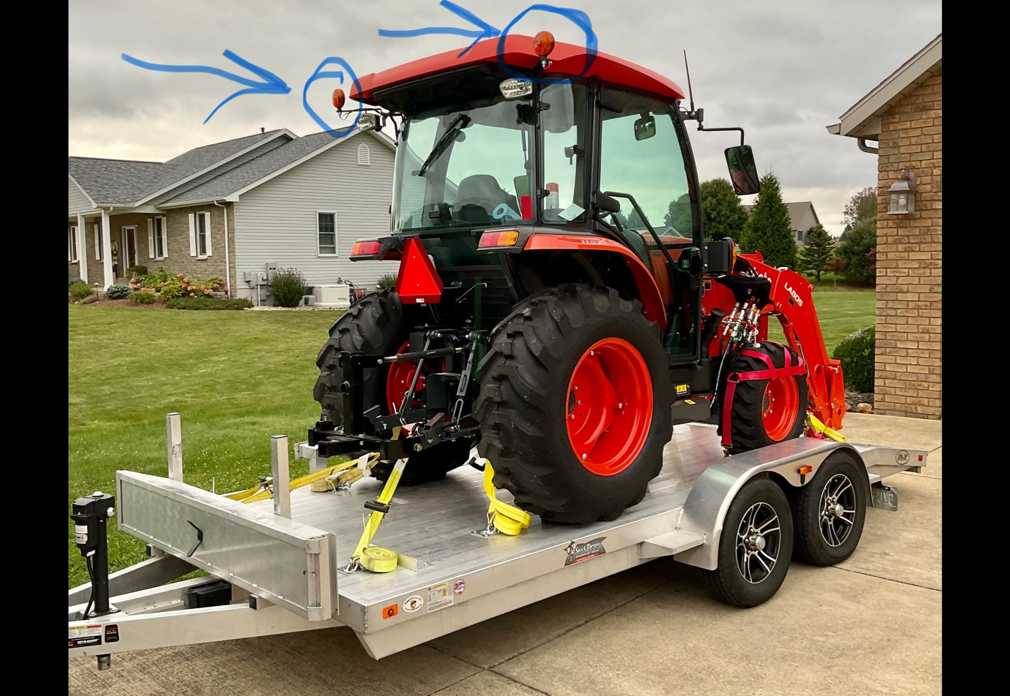

I noticed that my back right amber lenses (front n back) fell of the light. Can I buy just the lense or do I have to buy the light assembly? Cost idea?

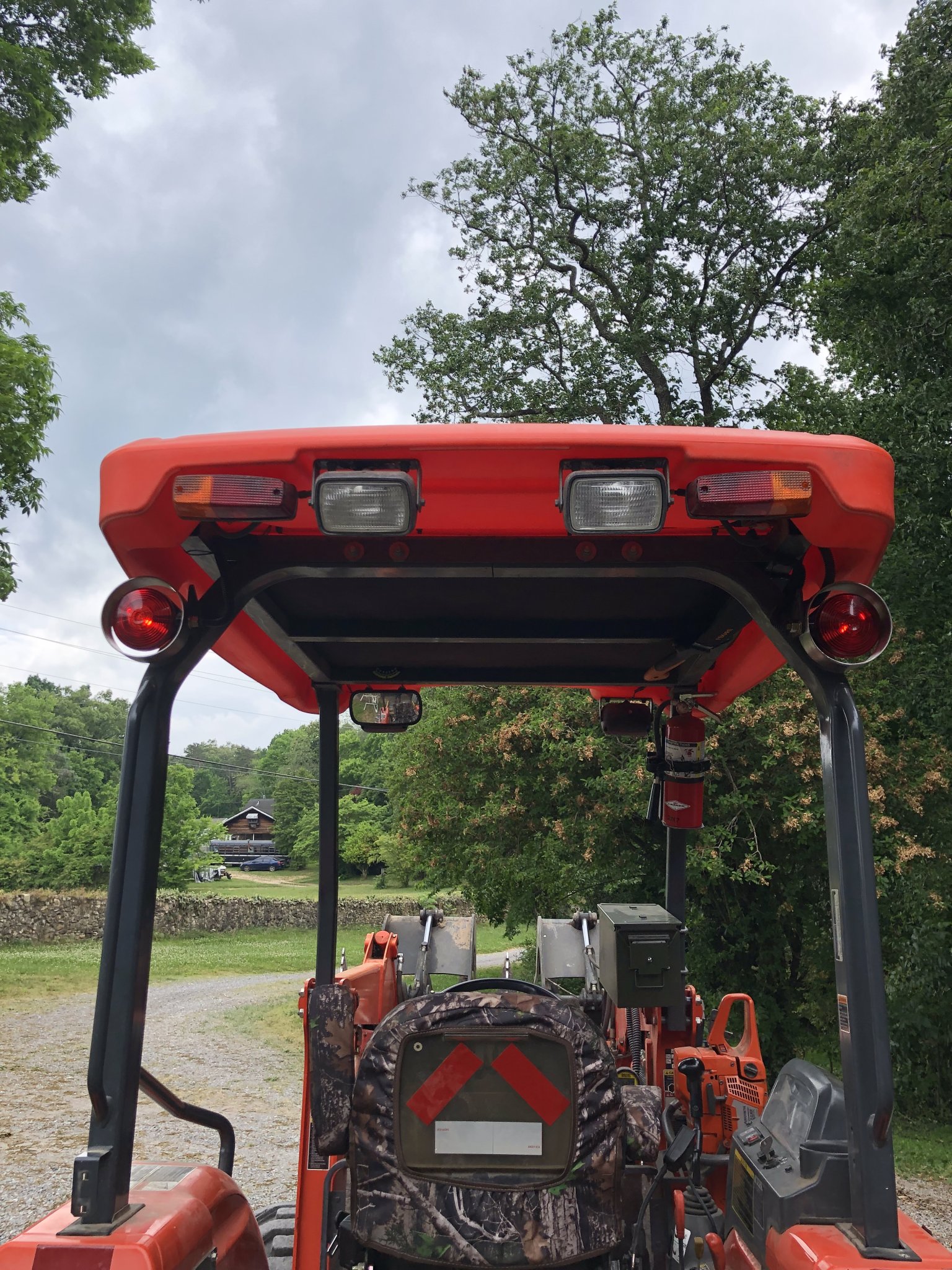

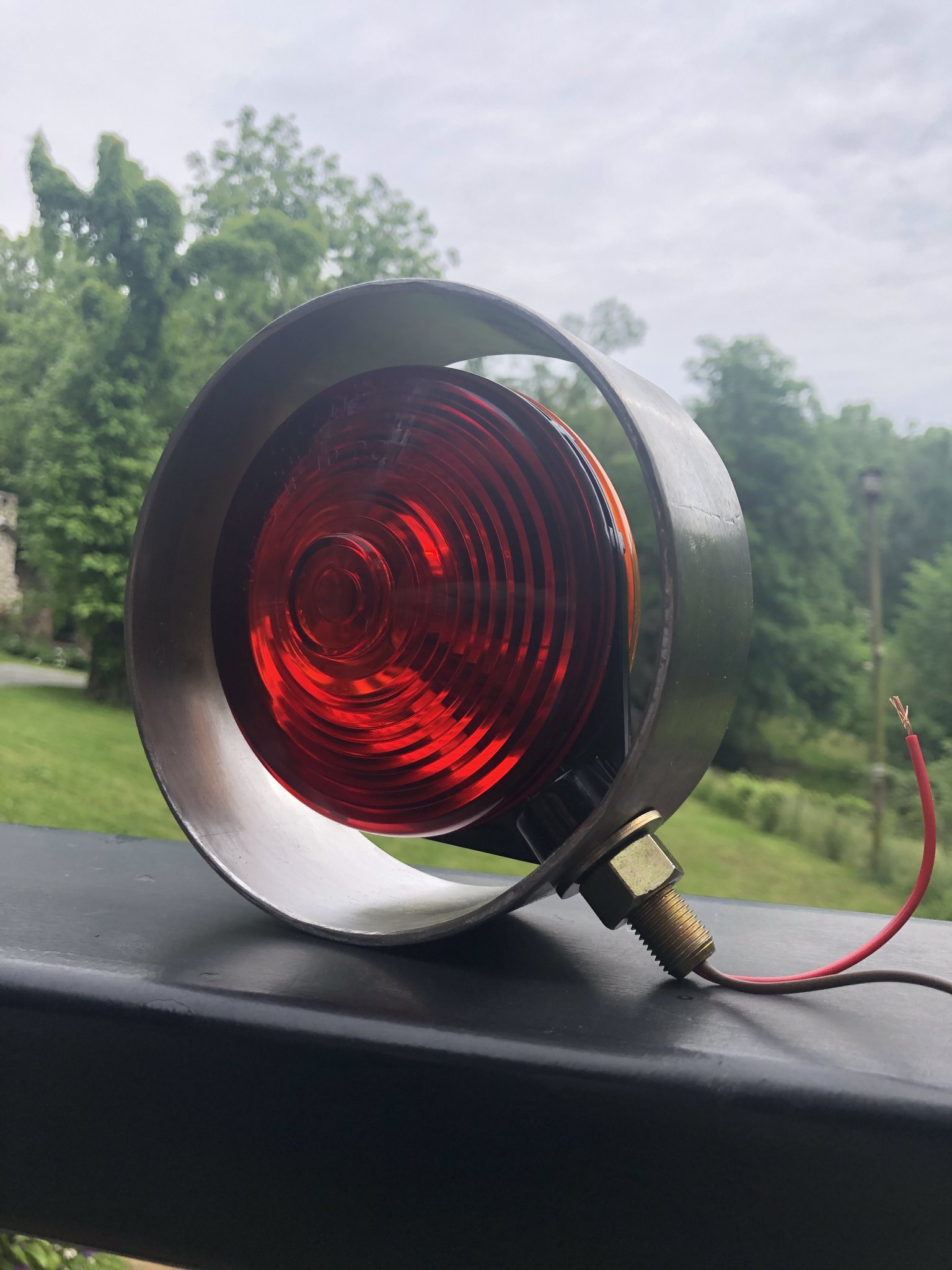

Work around a lot of trees and damage or loosing lens was a problem. A nylon wire across the lens helped secured them. Tractor supply had the Best Buy on hoses type of fixtures. Could buy a whole fixture cheaper than one lens at Kubota.
Eventually made some guards from some stainless steel tubing. Easy fabrication. Has
helped the most. Paul Short makes them and have seen them on eBay made from painted steel.

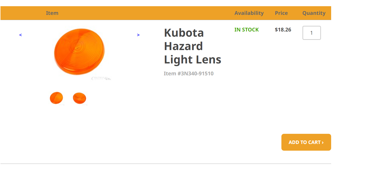

Yes you can buy replacement lenses, I seem to remember mine was like $10-20. Like Smokeydog I had some schedule 40 pipe kicking around and I made some light protectors.

Looks like someone went out of their way to mount them in a vulnerable spot. Ten bucks for the whole thing:

I have knocked my off. A lot cheaper to buy aftermarket. My dealer does not even stock the oem lens, but they do keep aftermarket ones to replace the oem ones.
