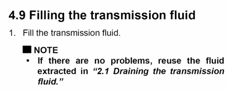

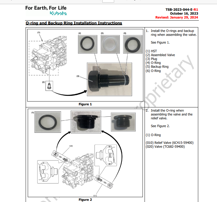

This picture fell off the back of a truck, it is page three of the TSB. :whistle:
It's the #3 plug that makes me wonder if it requires draining the fluid. On page 1 of the TSB there are links to Assembly Instructions on K-Service but you have to have a dealer log in to view those. IF the Kubota procedure says to drain the fluid then I shouldn't have to pay for that.

Perhaps they drain your fluid and then reuse the same fluid when the repair is completed?
I think your under the impression that, plug #1 is a drain plug, it's not it's a valve, and only a very small amount of fluid comes out when you take it out.
Even if it was a drain plug, a good tech can swap a plug and not loose but a spoon full of fluid.
