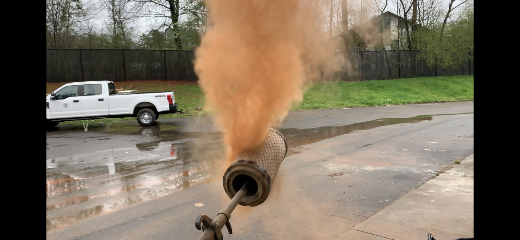

I think it's more likely that air filters aren't cleaned enough as opposed to too much so I would have no problem with every 10 hours. In the summer months I'll blow out the air filter at the end of the day if I've been running the tractors in dusty conditions. Both tractors have an outer and inner filter so I'm ok with end of day cleaning. I'll blow out the radiator a few times a day when pulling cutters around.
I have a couple of wands (shown below) that I use with a compressor at my place to blow out the filters, radiators and condensers, but use an Echo gas powered leaf blower when a tractor is off property. The Echo does a decent job and the air filter fits quite well on the end of the blower tube.

Whoa that's some dust!
Correct. But to be fair, this was a field rake that spends all of its time dragging ballfields, so very dusty conditions. I’ve tried to get the guys to blow them weekly instead of never. They are getting better.
