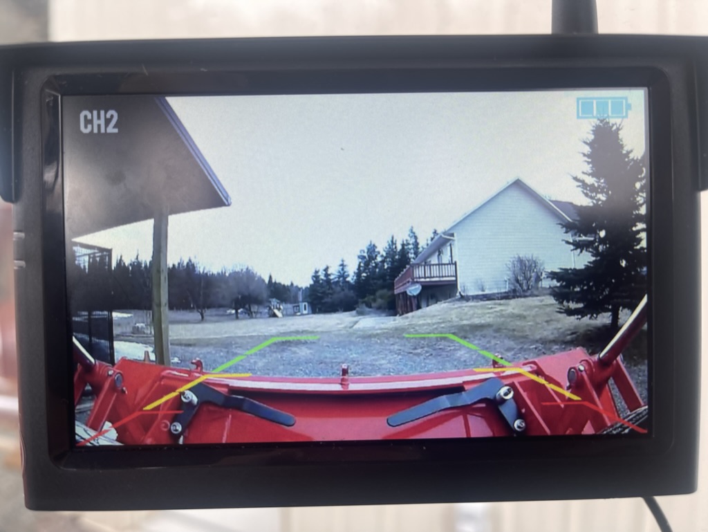

I use a wireless setup with solar powered cameras. The issue with this is you can't run the camera(s) continuously. No big deal as I use them for snagging implements.

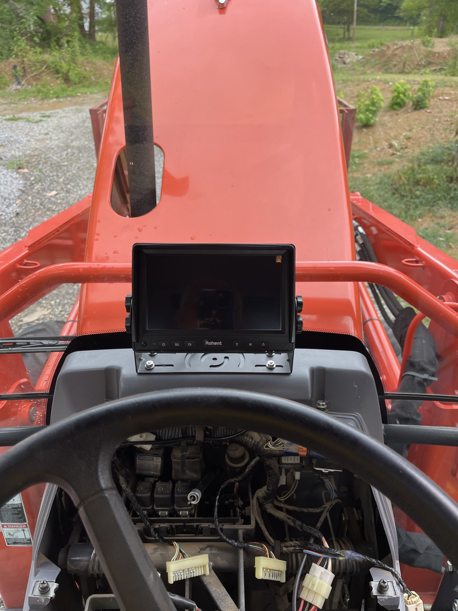

Thanks for the reply, my system is wired. Going to mount higher to get a viewing angle to see forks and 3 point hitch attachments. Started looking at how to wire and it appears that there is spare fuse holders. I have not hooked up volt meter to see if they work. How did you hook in the system?
What system brand did you use? You could probably add additional battery storage capacity to the camera if you wanted to.

Brand is Rohenk from Amazon, checked spare fuse holder in fuse box, not connected. Going to unmount fuse box and see if I can connect in back. If not have an adapter to split a fuse connection. Thank You

Thanks, that’s my back up plan. I already have one. I wanted to do wire into the fuse box if I can figure out how to do it.
