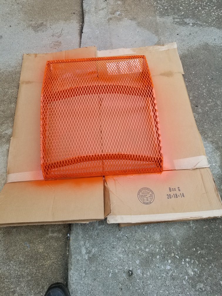

Add some expanded metal screening.

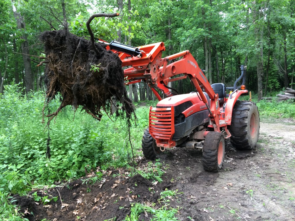

I ended up doing as Flip pointed out. I should take a recent picture of it because you can see it has absorbed lots of hits.

In my case, I MIG welded in the 5 flats and then the expanded metal to the back.

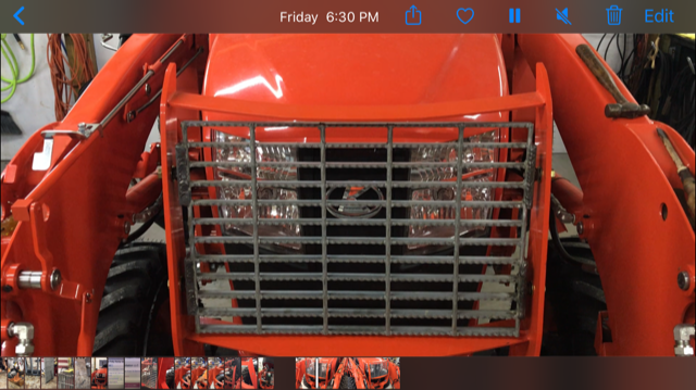

Another option here, would require more time and material...I already lost my grill and headlights to a branch while grappling, so no big loss to block the headlights. I was also able to add two grab hooks and d-ring while I had the grill off.

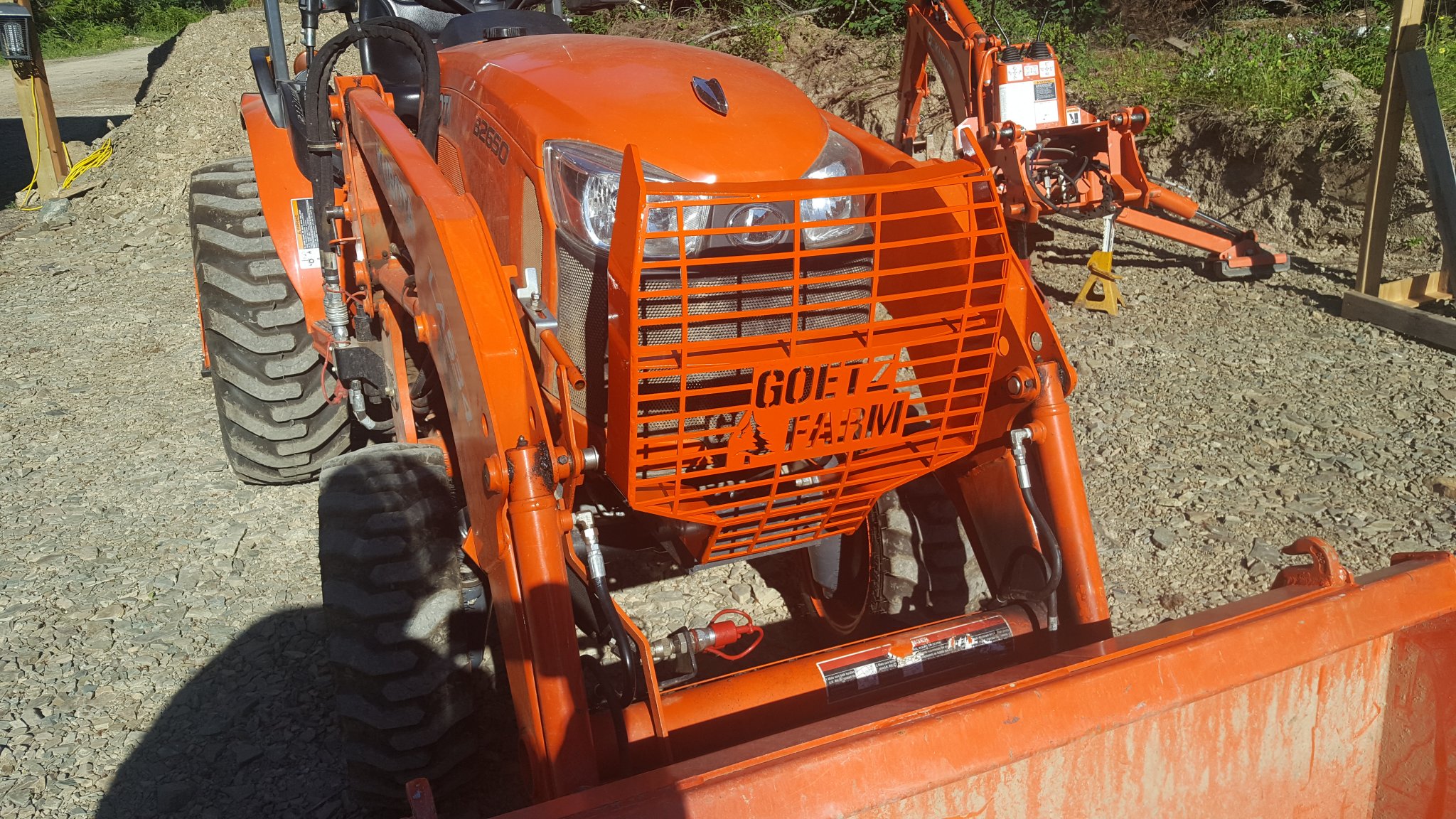

I am currently fabricating one in my shop. It is different than most that I see but is a very clean look and very stout. Mine is fabricated and then bolted on. I'll try and post my work on YouTube and add a link once completed. Until then...here's a pic!

That's a rugged guard and slick that it's removable.
