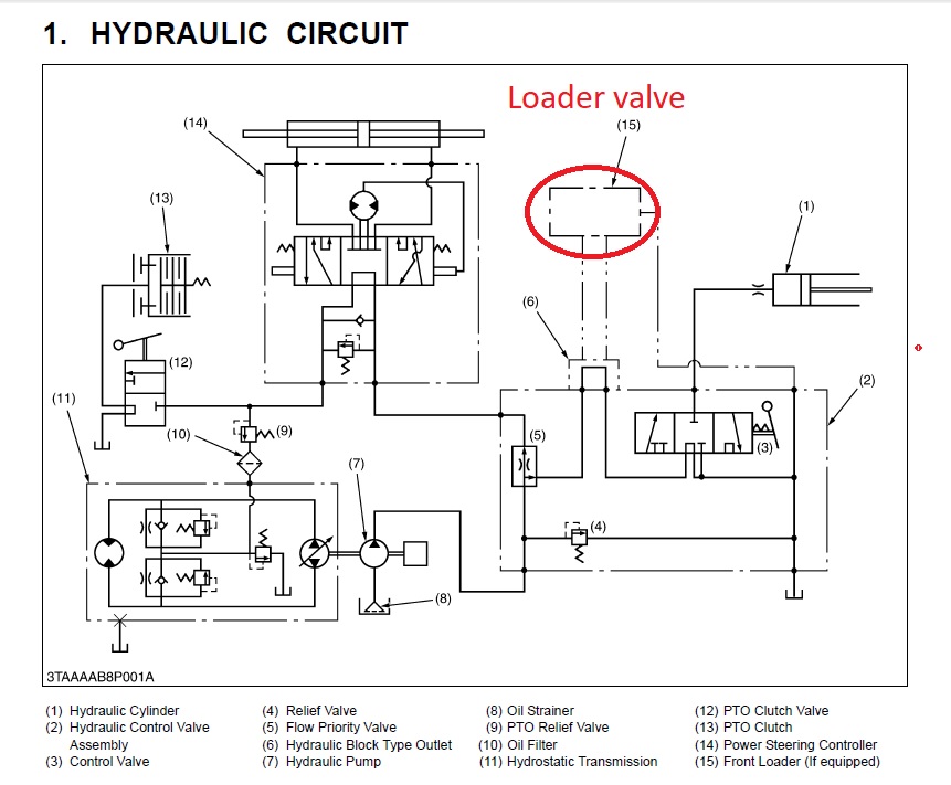

I do not know your tractor so the best I can do is give you some issues to reflect upon.
Your tractor has a hydraulic block which provides power for a loader valve which in turn controls a loader.

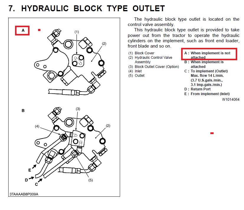

The WSM shows the hydraulic block configured two possible ways as shown below.
When you say: Bypass for the FEL is connected in its proper place
Are you referring to changes in the above block or something else?
Reading your description of what is happening, my first though is a couple of hoses swapped in their positions.
Does the loader valve come off with the loader or does it stay on the tractor?
The loader valve has a power beyond feature which powers the 3 pt hitch and any rear remotes.

The loader valve stays with the FEL.
I have the bypass hose in its proper place as it has not changed in 16 years when I remove the FEL.
I had raised one time after the tractor was restarted then it sounded like the valve that allowed fluid to go to the 3pt did not release but, it is on a handle that I move and when I put it in the down position the motor continues to be loaded. I suspect the 3pt load valve but it is a manual application.
Don't understand why when I put it in the down position it does not unload.

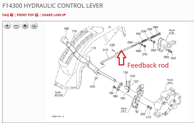

Check that the feedback rod is in place and not damaged. It is the link from the 3 pt hitch to the 3 pt control valve which should kick the control valve to a neutral position once the lift arms reach full height.

That lever is also in place and properly adjusted
Dave
The feedback rod is in place. I will check the adjustment this morning.

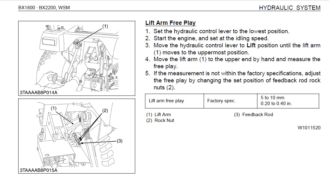

These instructions may help.
Dave
I looked at the feedback rod and it is in place and properly adjusted. I have no flow through one of my hydraulic lines leading to the FEL connectors and it is vibrating extremely bad.

When the loader is in place, its valve is the critical supply to the rear of the tractor using a function called Power Beyond.
As I told you in my first post I do not know your particular tractor but the basic principles of open center hydraulics do not change from tractor to tractor.
The hydraulic block outlet type is the place where the supply to the rear of the tractor occurs. The changing of covers depending upon an implement like a loader is attached or not is your clue to just how important this outlet block is.
I am not familiar with the FEL bypass you mention. It must take the place of changing outlet block covers.

On my tractor which is a BX2200D, the FEL is the holder of the control valve for the loader. There are three connections and a hose is left on the tractor, male end, which MUST be plugged into the female receptacle on the tractor or yes, the pump will burn out and this will also load the motor.
In the diagram you have above my "hydraulic block" type is "B" with the block and the steel lines coming off of it, and not "A".

With the engine side hose open, kick the starter momentarity with the goal of flushing out any pieces. Do not let the engine start or all your oil will be on the ground
Buy hose couplings for each end of the bypass hose to get back in business for now.
Do not use plumbing connections or fittings. Get real hydraulic ones. Somewhere in this hose loop you will need a fitting with a swivel so you can tighten connections up. You cannot keep rotating the hose to make all the connections at each end.
Dave,
Thanks again for all your help. I was getting in deeper than necessary for the problem though I did learn a lot about how all this works so it was worth it.
As it turned out it was the Male fitting that is in the picture I attached. There was no blockage other than the misaligned spring tip on the Male fitting.
I purchased some quality replacements and now my tractor is working as it should and I have a couple more replacement parts on the shelf now, just in case..
The hydraulic dealer I purchased these from said that the cause of the problem with the fitting was that there was a pressure spike. Could have been the Priority Valve, not sure. Everything is properly adjusted now and all is well.
