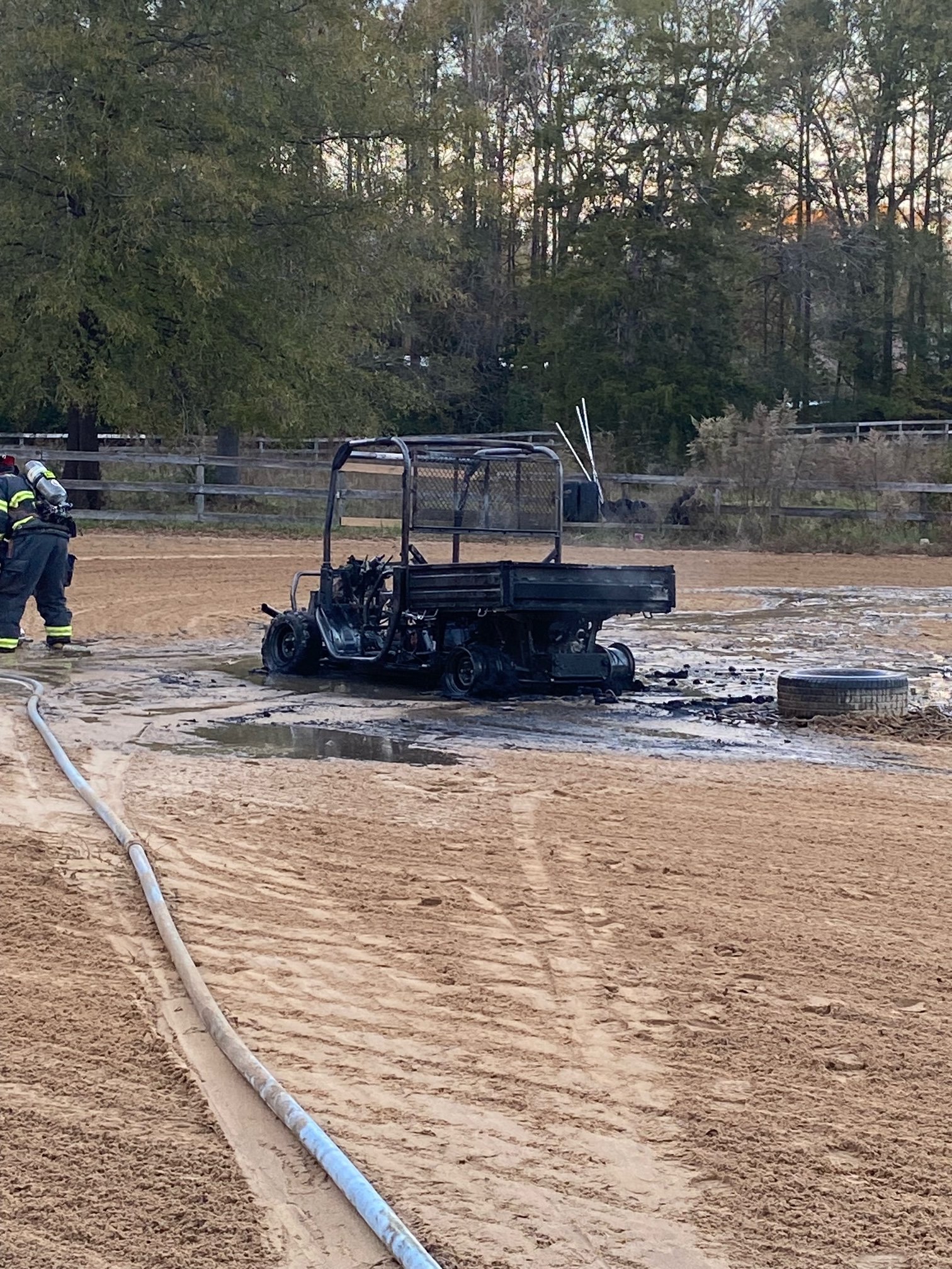

Hi, wondering if anyone has had issues with RTV catching fire?
I wasn't sure who to contact, but wanted to let Kubota know about an incident with our 2022 RTV X900. Had approximately 80 hours. This RTV caught fire and burned while dragging horse arena. We were not able to determine cause, but may be due to debris trapped under dump bed. We had been hauling leaves a few days prior to incident. But the hero of this story is Finley the Australian Shepherd, who began barking relentlessly at driver until she stopped to investigate.

Did you ask the firefighters if they had any idea of what caused the fire ? They usually have a pretty good team of investigators that can get to the probable cause. Did you have it well insured ?

The firefighters were unable to determine cause. Our insurance covered up to $10K of value, which unfortunately is not replacement value. Expensive lesson learned! :-(

dry vegetation near a hot muffler can and often does cause fire. Seen it quite a few times. Balers are notorious. Keep an extinguisher on the vehicle if at all possible.

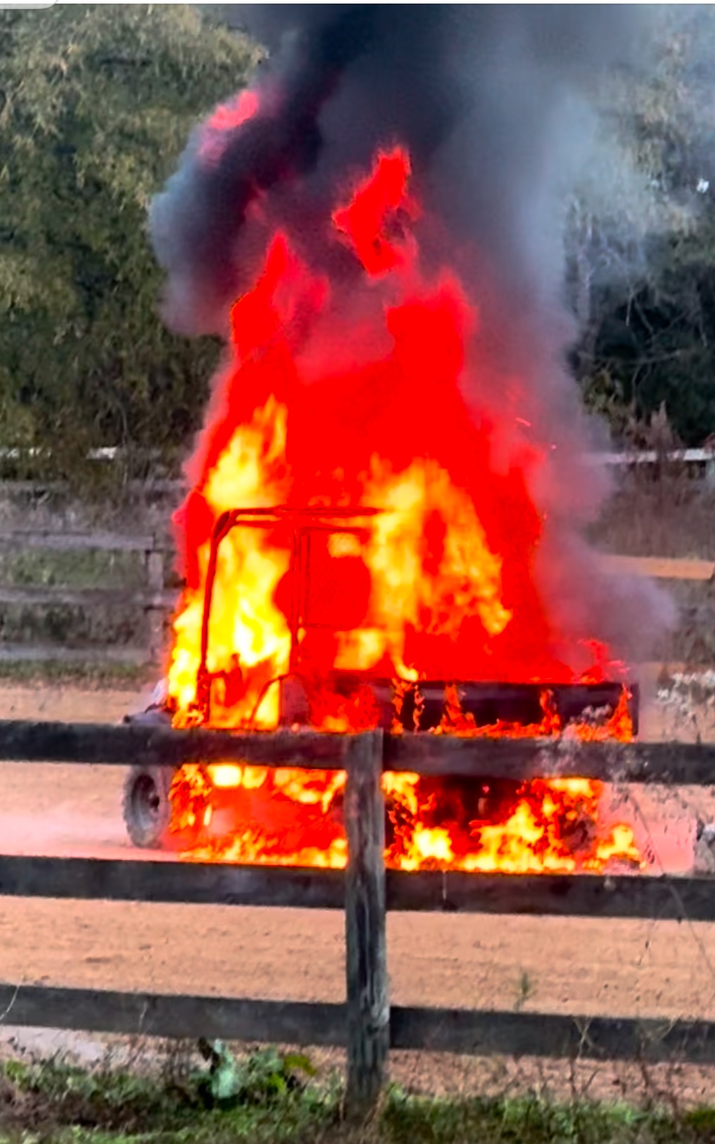

View attachment 143808 View attachment 143809 View attachment 143810
We also had an issue with our parked RTV 2024 RTVXG850 catching on fire while parked (around 11 pm at night). We only had it around 3 months, hadn't even used it a lot. Husband goes to bed around 8 pm. Noone was using it. Our heroes were neighbors but it caught our house on fire n neighbors house on fire before it was discovered.

rats will sometimes pack leaves and such on top of engines too. Always a good idea to raise the bed every so often and look around. I see these things too often (fire and more commonly potential fire) due to dry vegetation and/or rodents' nesting. And right now, birds nesting as well.
