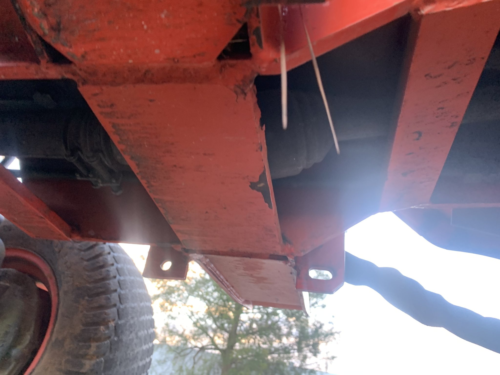

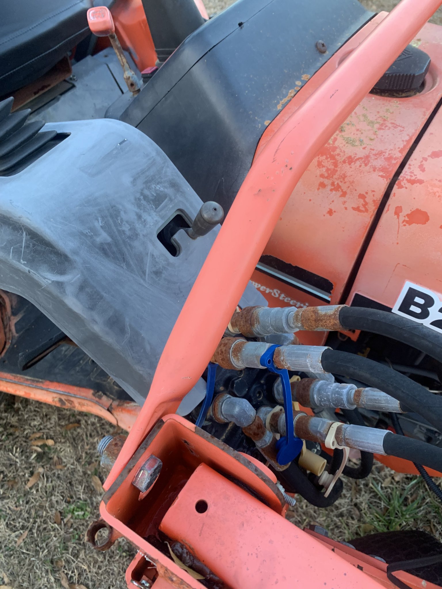

Hi Dave,
I used Traveller Premium Universal Tractor Fluid Trans/Hydraulic from Tractor Supply.
I'm not sure about the separate pump at the end of the crankshaft. I don't see anything obvious that looks like a pump and the only hydraulic lines coming from the trans go to the valve on the side that also works by loader. I'm in very unfamiliar territory here so I've attached a few pictures of the underneath to be sure.
The pto does not stop turning while the pto is engaged.
5,892
3,091
The B2710 is identical to my B 2910 except for engine HP from what I understand. There is no separate hydraulic pump for the loader.
Using anything other than Kubota fluids is not a good idea. I don’t know if they could cause the problem, and apparently are not the cause since you had the problem before you change the fluids. It’s always possible that the previous owner also used non-Kabota fluids and ended up damaging the seals or something in the HST side.
So the only help I can give us to say that there is no independent pump for the loader… I’m sure of that.
