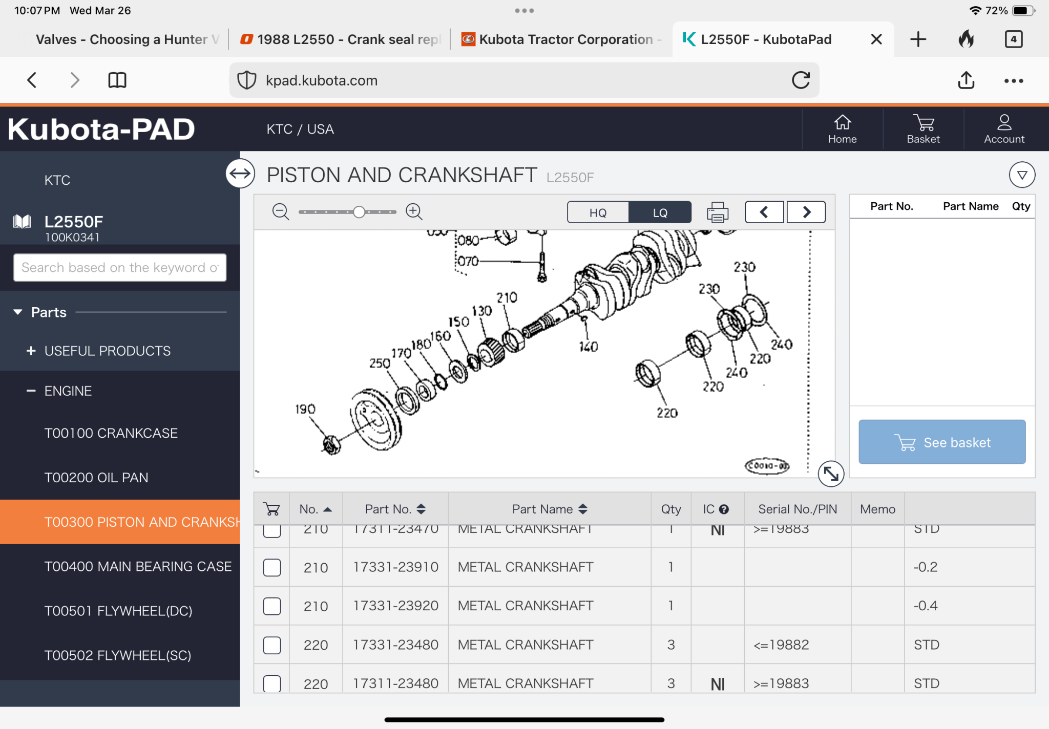

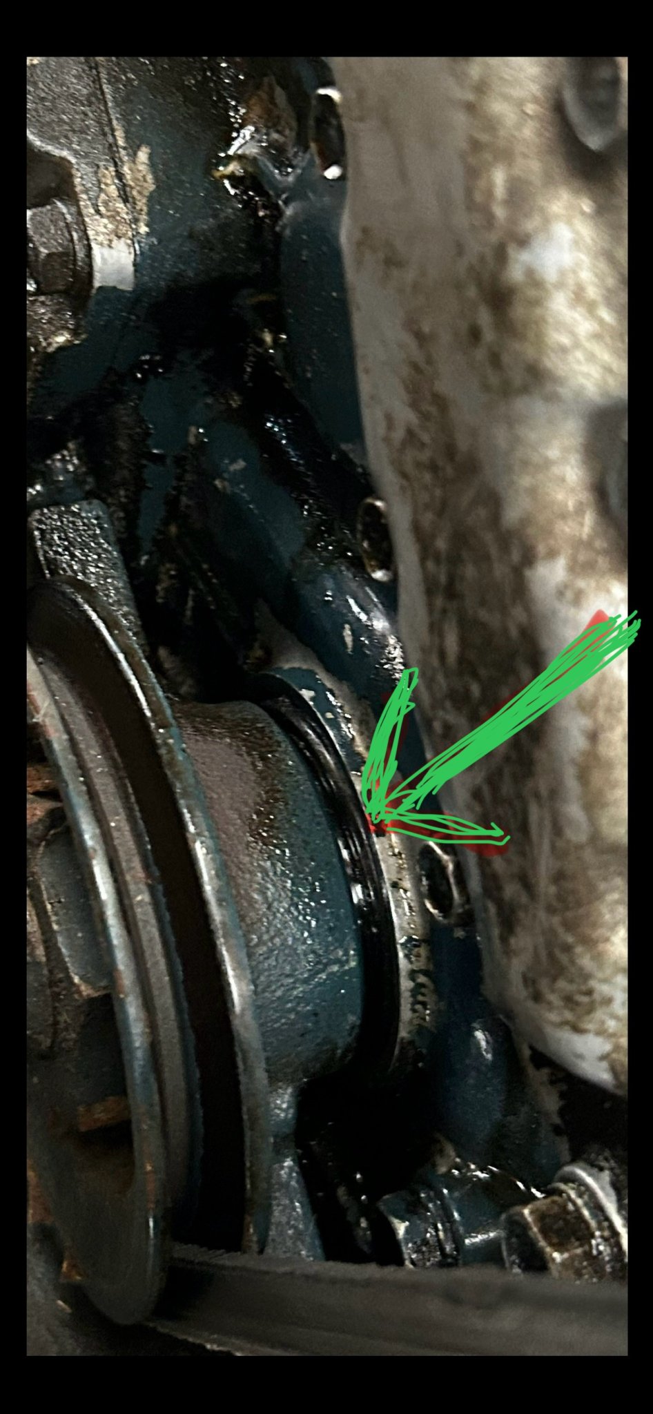

So now I am very confused.
See pictures for where the leak is. I thought this was the crank, and I need the crank seal but when I look up the parts schematic, I don’t see that balancer at all. It shows the pulley, collar and seal. So. Now I’m questioning what I’m looking at. I need to make sure I order the right seal and figure out how to fix this.
Can anyone tell me what I’m looking at and how to go about fixing the leak??” Any help would be greatly appreciated. I have about a month before I need to start using her.
Thanks again for everyone’s time - Kevin

Thank you. I’ll take the time to do that and double check. . I did have that area right on it cleaned up and saw bright metal of the shaft as it goes into the engine and when we started the machine it started weeping from there.. the rest in the area was what was cast off I believe
That is the crankshaft with the splined end. Here is the illustration from Kubota USA so you can find it there or on Messicks. There are several things that need to be replace - I think 210 should be replaced to make the seal work well but it may be something else.

You will need #170: collar, #180: O-ring and #250: oil seal
