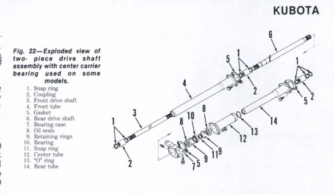

Thanks, I'll try spinning the wheels and see. I know the u joints on the shaft are suspect. They turn fine by hand but the front end is also fine on low speed. It's anything above low speed with a load on it that becomes a problem. I'll look at the schematic and see what's inside the axle.
